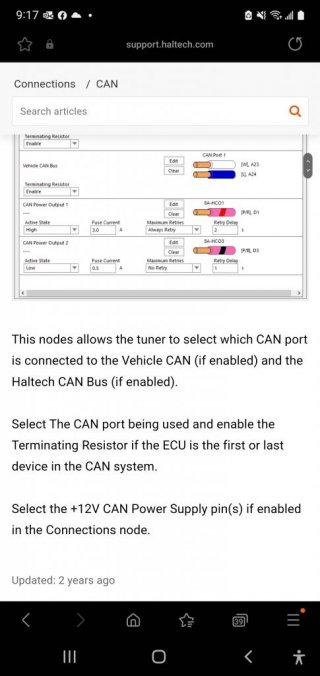

The CAN lines are on the OBD port, yes they go thru a gateway too. Could be 1 or 2 other busses that's on. You have also a body CAN bus, which is nice, because it has data available while the vehicle is off.
You could always bypass the gateway and go directly to the other busses if you have the wiring info of your vehicle
vehicle doesnt need any termination at all as they have their own, in some circumnstances it can cause the dash to light up for some vehicles, false positive errors on the bus
