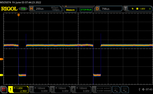

On a Teensy 3.2 here is the output

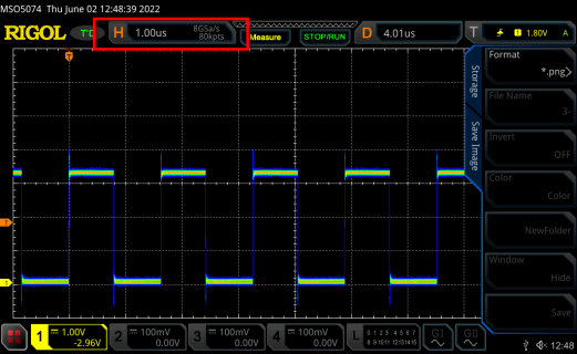

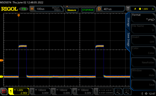

and on a Teensy 4.0 here is the output. Note that the duty cycle is wrong and the timebase changed
and a secondary issue in the Teensy 3.2. The durations are 1/2 of what I expected. I expected a pulse train high for 0.1mS and low for 0.9mS. In my original 3.2 production code I just multiplied by 2 and moved on ...

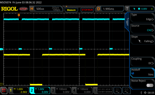

Vindar and Kurt - Thanks! I made the changes that Vindar recommended. Curiously the waveform is inverted(!) and the timing is different between the 3.2 and 4.0. At least the periods are correct for the 4.0
The blue trace is the 4.0 and the yellow is the 3.2. They are not synched so the edges do not line up
In TimerOne.h, the initialize method is an alias for setPeriod with a default value of 1S. Likewise restart is an alias of start
The start method also calls stop() so it looks like the correct way of using the timer is to load in your desired period via intialize/setPeriod and then call start/resume if you want the change to implement immediately (before the timer counts down to zero and reloads).

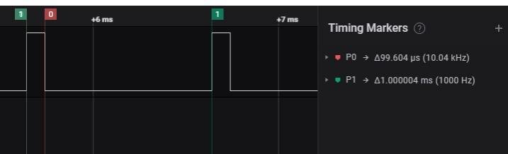

I had a related issue. I'm working on a project using Teensy 4.1. Among other features, it includes a 4 inch 480x320 SPI display with PWM backligght control. Pin 25 was used for this purpose. But TimerOne screwed-up PWM output. Duty cycle was half the expected one: when I analog-wrote 255, duty cycle was 50%. It wasn't possible to get more than 50% duty cycle (analog-writing 511 resulted in 50% duty cycle, too). And PWM frequency changed. Switching to IntervalTimer cured the issue.
Just for the records, some images. Oscilloscope screen capture after analog-writing 230 to pin 25. All normal.
