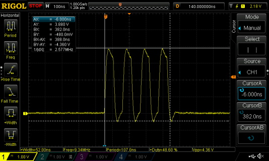

Using a scope I measured the ISR latency (attachInterrupt) using the PWM source and pin toggle in the ISR. The fastest PWM rate was 333 Khz (period 3 us). This is much slower than Teensy 3 as seen in the following table. ISR overhead for ARM is about 50 cycles, so we might expect the 600 MHz M7 to have a latency of 83 ns (12 MHz).
ISR latency (attachInterrupt) PWM frequency and period
T3.2@120mhz 1.2 MHz 835 ns FASTISR 2.6 MHz 384 ns
T3.6@180mhz 1.7 582 3.4 300
M7@600mhz 0.33 3000

To test power consumption at different frequencies, I ran the SDK power_mode_switch app, described here, with meter and hacked USB cable. At 600 MHz the app/board consumed 158.9 ma, @528mhz 150.3 ma, @132mhz 116.9 ma, and @24mhz 93.9 ma. The specs say the MCU should consume 0.11ma/MHz.
Various clocks with MCU @600MHz
CPU: 600000000 Hz
AHB: 600000000 Hz
SEMC: 75000000 Hz
IPG: 150000000 Hz
OSC: 24000000 Hz
RTC: 32768 Hz
ARMPLL: 1200000000 Hz
