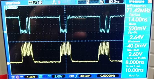

Is that a Rigol 1000Z series scope?
Those are at most 100 MHz bandwidth, and have 150 MHz probes, right?

If you are not using 8-bit frame size, then you may have to worry about byte order. Conveniently, the 1052 LPSPI has a control bit to re-order bytes, BYSW in TCR.However the data printed didn't come over in sequential order - have to figure that one out. Been testing speeds and waveform but wanted to see if data transfers were actually working correctly
