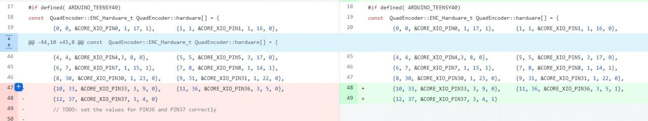

I noticed the library does not support pin 36 for the Teensy MICROMOD, only for T4.1. I can understand why T4.0 doesn't support (no logical pin 36), but why doesn't the MICROMOD support the hardware encoder on it's logical pin 36? Is it not the same CPU ball as pin36 on the T4.1?
With some schematic checking I may have answered my own question. On the MICROMOD, logical pin 36 is B0_01, on Teensy 4.1, logical pin 36 is B1_02.
I'm guessing B1_02 supports the hardware encoder but B0_01 does not?
In the RT1062 programming guide, it looks MICROMOD pin 36 (B0_01) is connected to XBAR1_INOUT05, ALT3. I tried modifying the QuadEncoder.* files but can't seem to get it to work. Can someone explain why logical Pin 36 on the MICROMOD cannot support the hardware encoder?
Actually pins 36 and 37 are supported but for the Teensy 4.1. Looks like I put the ifdef in the wrong spot - its against the Teensy 4 and not the Teens4.1.
Just pushed the change to the library to: https://github.com/mjs513/Teensy-4.x-Quad-Encoder-Library. If you want to give it a try.
Hi @mjs513, I tried your lastest change and unfortunately it does not work. However, there are still a couple issues that I can see I am pretty sure need to be resolved to support MicroMOD properly.
- QuadEncoder.h only defines the CORE_XIO_PIN36 for Teensy41, not MicroMOD, and this definition must be different for T4.1 vs MicroMOD because pins 36/37 are on different CPU balls, thus the XBAR1 I/O is different as well.
- QuadEncoder.cpp needs to have separate Hardware_t structures for each of the supported hardware platforms because out of the three (T4.0, T4.1, and MicroMOD) none are completely identical.
I've created a pull request here to demonstrate some of what I think the solution is, but I am not sure how to set all the values correctly in Hardware_t for MicroMOD. You help is greatly appreciated! I am using 4 encoders on my project and designed it to put all four on H/W encoder pins.
Here is the PR on Github (again, it doesn't work, but it illustrates what I'm doing. We can merge once we get it working).
https://github.com/mjs513/Teensy-4.x-Quad-Encoder-Library/pull/8
Here is the config for the four encoders. Three of them work fine. The one using pins 31/316 does not. If I replace it with the software based Encoder class, it works fine so hardware should be good.

Went ahead and merged your changes since those were the tables that had to be created for the MicroMod. Made one change for the io-mux value for pins 36/37 and its now working:
Thanks for taking the changes and doing the leg work. Let me know if its working for you.
