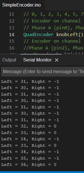

Hi mjs513
I'm having a curious issue with this library when definint phase A as pin1 and phase B as pin 3 on a Teensy 4.1.
The signal and phase offset looks good on the scope (there is overshoot and a little ringing) but it only randomly counts +- a count occasionaly.
If I define pin 2 to be phase A the whole lot works fine.
I have changed the teensy 4.1 to make sure it is not a hardware issue and the problem occurs with both.
I note that UART1 default Tx is also Pin1. I am not using this UART but I am wondering if I need to disable that mapping somewhere in case that is keeping pin1 defined as an output somehow?

That really is strange. I just did a simple setup with a KY-040 rotatary encoder attached to pins 1 and 3 to try and duplicate. I then ran the simple encoder example and it did not have a problem working:
You could try telling it to use pullups:
QuadEncoder knobLeft(1, 1, 3,1);
to see if it helps.
Also could be something in the sketch or your hardware? Does it work with Paul's Encoder library?
The Encoder example available from the Arduino list works just fine, is this using your library?
If so, there is obviously something in my project screwing things up.... will need to dig around and look for anything playing with pin 1...
The example above is using the QuadEncoder Library.
