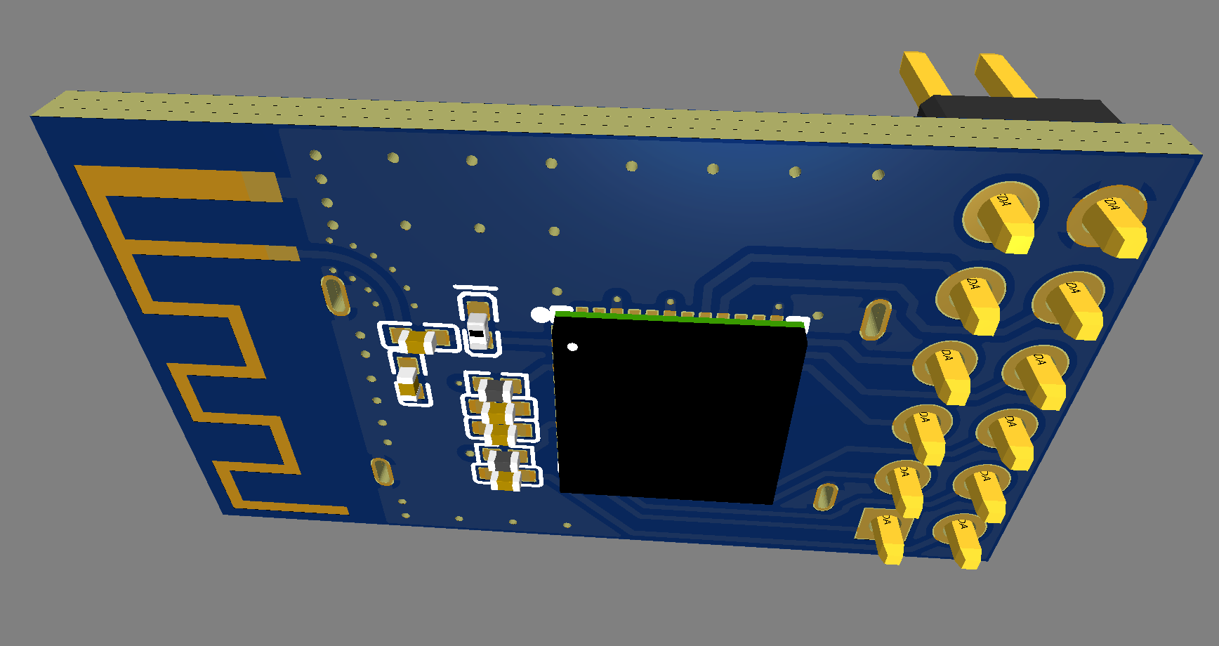

I have done some more sleuthing and for the board that @defragster is using (ESP Pico Kit v4.1) the following SPI pins are declared/available:
mosi - vspid 23, hspid 13
miso - vspiq 19, hspiq 12
clk - vspiclk 18, hspiclk 14
cs - vspics0 5, hspics0 15
Thanks - GREAT Work @BriComp finding that: SPISClass SPIS(VSPI_HOST, 1, 12, 23, 18, 5, 33);
> though not sure what 1,12 {12 is Hspi MISO) is and where is 19 for MISO on Vspi
Didn't get to look much today - I can confirm that p#12 is what I got and am trying for Vspi, and pin 33.
> I have a POOR print of the board and was finding the "H" alternate pins to the "V" pins I have wired.
> --- making a higher quality print of DevKit PICO, and the schematic you found for AdaFBreakout
If I'm reading this right, they are using Hspi pins! MCU:15,14,13 {<EDIT>: pretty sure that isn't right ...}
I didn't even get to verify my wires with today's interruptions.
I wonder if I should swap pin 19 to 12 ??? - that didn't do it ... I'll have to look after Zzzz's later 'today'
PCB is wired and awkward and the silkscreen is tiny and not as clear as on a Teensy - hard to move with 10 wires ... can't imagine the wire troubles on the parallel displays - will be good to have the @KurtE board when I hook one up :) I could move it to a breadboard - maybe should and use real wire instead of the 'bulk' current wires.
I think you will find that those are the hardware pin numbers, not the MCU pin numbers.
From what I can see the Adafruit modified WiFiNina uses the following SPIS setup: SPISClass SPIS(VSPI_HOST, 1, [B]14[/B], 23, 18, 5, 33);
Note the change to MCU pin 14 for MOSI (vspid).
As I see it the AdaFruit (and also Arduino) WiFiNina WILL NOT WORK with the ESP32 PICO D4.
If VSPI is to be used then SPISClass will need to be changed to SPISClass SPIS(VSPI_HOST, 1, 23, 19, 18, 5, 33);
Ok, further Sleuthing. SPI Pins as used by various ESP32s are shown below.
You can see that the ESP32 PICO D4 pin assignments match the UBLOX W10 used with the Nano33IoTV2.0 and UNO V2 Wifi.
So if you load the Arduino version of WiFiNINA onto the PICO D4 it might work.
I am confused by the indication of use of GPIO12 for MISO as it comes from the H channel.
It might be that they are using both V and H channels to speed throughput??!! That is the only thing I can think of.
GOT IT: Went to the schematic for the 4201 AdaF Breakout - and the AdaF linked 1.7.7 firmware

I made a custom WiFi module back in the day when this was current.
I never ordered the board but I looked it over and I did all the work. I will order it, do you guys one to play with?
