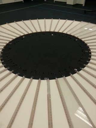

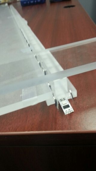

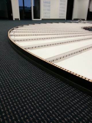

To start off with a new design I want to just work on the floor which is a 16' diameter circle that has a 7' circle cut out of the middle, it looks like a ring. The circle has 48 floor supports that we call 'ribs' and each rib has 3 strands of LEDs on them which have 45 LEDs each. The ribs have one strand down the middle facing up and the other two strands face the sides. There is a total of 144 strands of LEDs in the floor (3 X 48 = 144). There are 8 sections to the floor making and each section has 6 ribs equaling 810 (3 strands X 45 LEDs X 6 ribs = 810).
I would like to have the floor be modular, able to remove any section and still function. A total of 8 sections.
