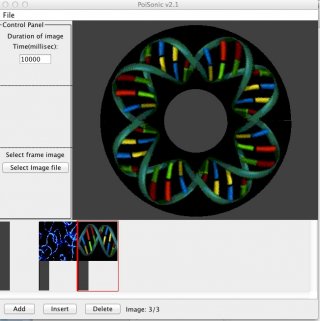

The simple image utility for the APA102 24bit image arrays to use them in graphic poi / pixel poi can be found here:
http://www.orchardelica.com/poisonic/poi_page.html
EDIT: @howsthe weather has improved the browser based image converter utility: "If you'd like to use (or modify) my brother's enhanced version of Mortonkopf's image conversion utility, it is available here : https://jhorowitz.github.io/PoiSonicApa102ImageConverter/."
