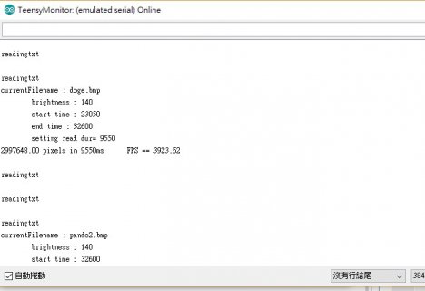

Hi guys,
I got a new score on refreshing rate.
this doge.bmp is a 24bit bmp with a width of 80 pixel and gets a horrible 3900 FPS, that squeezes the image
okay, when it goes to DMASPI it turns out that FPS depends highly on micro-SD cards, but not by size (as this one uses a 128Mbyte card, could be pretty old)
I'm still finding if there is something deciding.
