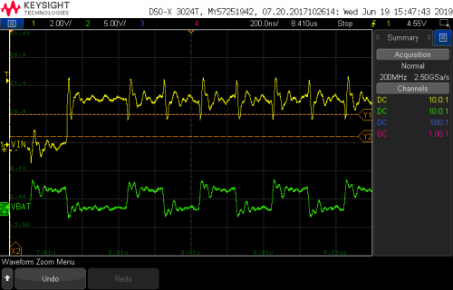

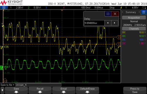

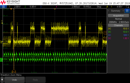

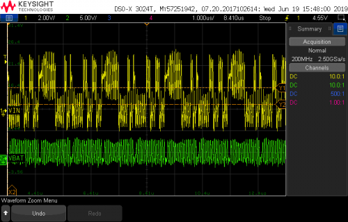

Hello Again,
So I wanted to start getting some real data and tests in before searching for more help here. A co-worker hooked the setup to a scope and it appears like we are getting some dirty data utilizing SPI and it's causing issues with freezing and inconsistency.
Maybe I am missing something simple here about how everything should be setup. Do I need to add caps, resistors anywhere in particular to help with this? I am doubtful it's a power issue, but possible? The wires were fairly long for the data and clock line, perhaps this leads to more issues than I'd expect? Hopefully someone here can chime in and shed some light on what's going on. Let me know what you all think.
See attached scope captures and sketch.
First set of captures were taken at 120MHz core clock and 2MHz SPI clock rate
Second set of captures were taken at 120MHz core clock and 12MHz SPI clock rate
The green trace is SCK (Clock) and the yellow trace is MOSI (Data from Teensy to LED strip)
The attached image was used to create the array in the sketch.
The code used is below.
