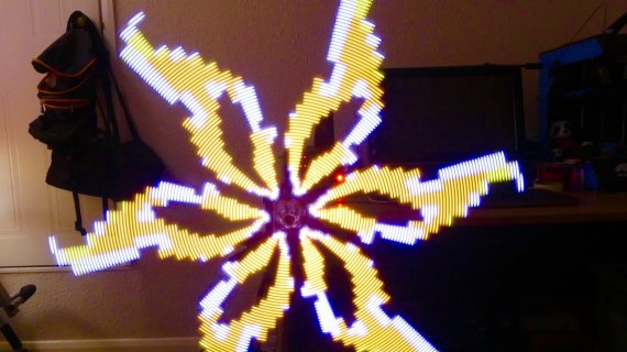

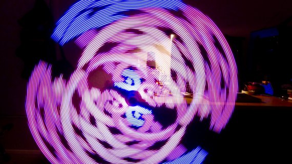

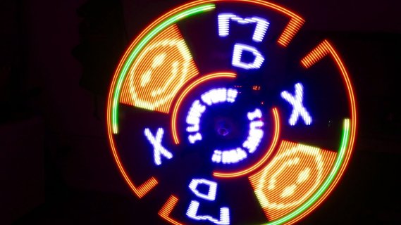

Greetings, not sure how alive this thread still is - I'm usually late to the party. Discovered LED poi this summer when a friend had some at a wedding we were at... and they were the Ignis ones, and cost a fortune. I suspected it could be done a *lot* cheaper and I have some coding / hacking experience so started trying to pull something together with bits I had lying around. These examples use the WS2812b strip, which I have since learnt really don't have the refresh rate required (and also look v. blocky compared to ones I've seen running the AP102 strips. I now have some of the APA102s on order - looking forward to more experimenting. Kudos to @mortonkopf and everyone else here for the work people have put into this already. 👏👏👏
