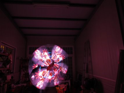

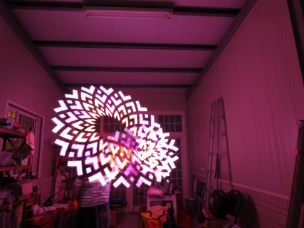

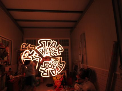

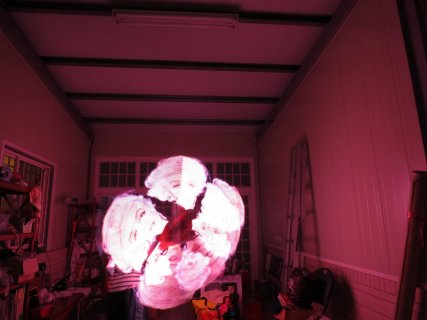

reporting my progress here, since 2015Sept,
this is one of the post I first referenced, to start building my own POV (the other's octows2812 proj)
using teensy 3.6 and features below
SDio & apa102 & FastLED CRGB->DMASPI
reading from SDio ontime, can get a 1,666 FPS with 24 bit BMP (256 color bmp even gives more FPS) on 90'pixel apa102 strips.
Finally, I've complete a POV that can possibly compete with those luxury products
thanks to T3.6 and SDIO interface, otherwise I'll stuck at speed.
thanks to Paul and all supporters online~
still moving on for my custom LED strips with 3528, which promisingly will grant much denser POV effects.
edit:add attachments, sorry for the camera settings,
