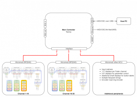

I'm currently developing a Midi controller to control GrandMa on Pc (Lighting control software).

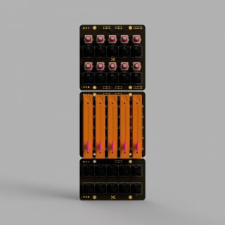

The main part of the controller is the fader wing. It consists of buttons, encoders and motorized faders.
These are controlled through dedicated chips by a RP2040 over i2c. A simplified schematic is attached.
I've already got these PCBs produced and tested them successfully.
At the current stage I'm thinking about how to tie the fader wings and future expansion together (See the second schematic).
The RP2040 could be used standalone as it does supports MIDI over usb, which is the main thing I need.
But I though about using a more powerful and feature rich MCU to increase performance and allow for as much expandability as possible.
The Teensy 4/4.1 could be a good option, but the RT117x seems to be even more promising (1GHz, dual ethernet with TSN, 2D GPU, etc...).
I've read the Future Teensy feature thread, where the RT117x is already mentioned.
This would be great as developing a board incorporating this MCU on my own is not an option.
Furthermore all currently available dev boards do not seem a good option (Coral micro, EA uCOM, Avnet MaaXboard) due to support, availability, footprint or pinout.
Now that I want to start developing the firmware, I could use a currently available Teensy board with the plan to migrate to a next gen Teensy board.
I'm aware that I'm relying on something that does not exist yet, but this is a hobbyist project with an open timeframe, thus I'm willing to give it a shot
Would this be a viable temporary solution? How much effort would it be to migrate from a Teensy 4/4.1 to a RT117x?
And last but not least, can there be anything said regarding a potential Teensy 4.1 successor?
I would appreciate helpful input regarding this.

Somewhere it was said that there can't be expected any newer Teensy in the foreseeable future. You should find it somewhere in this forum in posts from the last weeks.
For a sophisticated MIDI controller even a Teensy 4.1 looks extremely powerful to me with a lot of pins. What exactly are you missing? Why not focus on a device with that?
Possible bottlenecks I could see would be the number of pins for such huge number of encoders. Controlling displays can be sometimes difficult when the sending of the data is blocking everything else. Nothing of that is a matter of processing power or memory.

It really depends on whether your code makes use of libraries or directly accesses hardware registers. The more you access the hardware directly, the more tightly tied your code becomes to that specific hardware. Sometimes this is necessary for the highest performance. But often functions like digitalWriteFast() are highly optimized and give the same performance as directly writing to the register.
So my main advice is to ask here on the forum if you're working with the libraries and you need higher performance. And quite often the way to achieve higher performance involves using a different approach, so best to ask early and be open minded about ideas to do things differently. Usually when people are near the end of a project and a lot of slow-but-working code is written, changing course becomes a lot harder.
This modular approach is good. All to often we see people attempt a huge MIDI controller project which becomes too much to build and troubleshoot. Building it as modules greatly improves your chances for success.
But if you are concerned about performance, I would urge you to reconsider I2C. Most I2C chips can communicate at 400 kHz and some even 1 MHz if the wires are short and not much else connected. But if you create a long chain of many chips, even if each would be able to use 400 kHz by itself, you might end up with a situation where the whole bus is limited to 100 kHz speed to the long wires and capacitive load of so many chips.
USB might be a better choice. Chips like RP2040 only support 12 Mbit/sec speed, but that's still a lot faster than 0.4 or 0.1 MHz typical on I2C. Teensy's USB host port supports 480 Mbit/sec speed. If you use a good multi-TT USB hub, all the downstream 12 Mbit devices can use their full bandwidth simultaneously on the 480 Mbit connection to Teensy 4. Even if you use a cheap single-TT hub, 12 Mbit is still a lot faster than I2C. USB also uses very efficient bus master DMA, so the CPU overhead is a much lower than I2C.

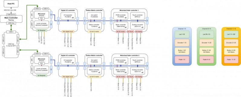

For the 3 fader wings I split the i2c bus into two separate buses. Each controlled by a RP2040. Future expansions will adopt this approach if it works.
To each i2c bus there are no more than 10 devices connected.
I decided to use i2c devices to expand i/o instead of serialisation (like midibox does). With the though of easier expandability and embedded development.
This could be a solution to connect the MCU's to the Main processor. I looked into this and found a promissing Usb hub. The attached updated schematic shows how I imagine this could be implemented.
A major open decisions is the platform of the main controller. The Teensy can handle all the i/o of the midi controller, that's fine.
But I'm unsure regarding the auxiliary functions I mentioned above. I want to use this project as a platform to get more into embedded development.
That's why I want to "futureproof" the main controller. I do not want to change the platform half way through.
What could be a solution which fits the requirements I outlined? I thought about adding a processor (RT117/STM32H7) with more peripherals on top of the Teensy. Or maybe even a MPU (STM32MP1/Raspberry Pi).On the one hand this could allow me to start now with the development of the hardware control and expand the system in the future. On the other hand this would add another even more complex component to the system.
If you have helpful input or even an idea how to tackle this, it would be greatly appreciated!

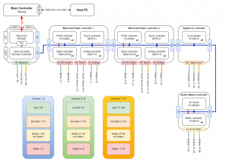

I've updated the schematic again to distribute the devices more equally.
