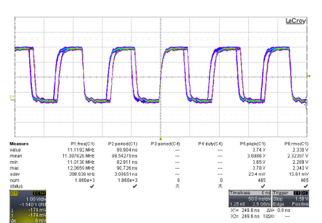

I love the Teensy audio board (just got it yesterday). However, the audio clock MCLK is not stable, which is the cause of some icky distortion.
In the attached image, you can see the MCLK signal (pin 11), and clearly it has bi-modal duration with periods of about 90 ns and 82ns.
This definitely will not produce good sounding audio on record and playback.
Is there any way to make that clock stable? I have not looked into the hardware and software yet to see how MCLK is generated.

Trigger your scope on LRCLK (synchronous to the actual sample rate), for a better view of what the codec really sees.
Indeed the clock has different length cycles at 72 MHz, since there isn't a perfect divider to create it.
You can just do a search for 'audio clock jitter' on google to see the issues. The MCLK should be very stable because it's what drives the entire audio conversion process. If it's not stable you'll get sidelobes in the converted data.

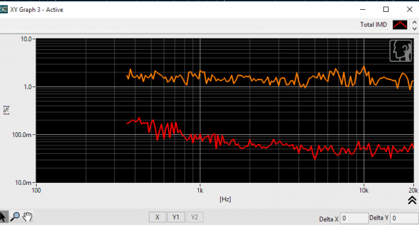

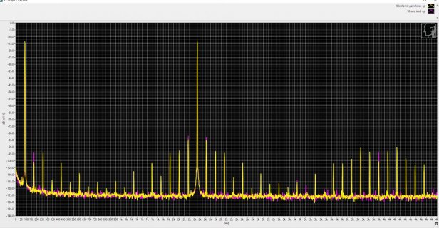

Okay,
I measured the IMD using the built-in sine generators (so I didn't have to use the ADCs -- which are very noisy for my setup... will be a subject of another post), and the results say... the differences are measurable, but only barely.
First the sketch I used to generate a dual-tone signal that should show the IMD problems:
#include <SerialFlash.h>
AudioSynthWaveformSine   sine2;          //xy=173,146
AudioSynthWaveformSine   sine1;          //xy=182,108
AudioMixer4              mixer1;         //xy=363,121
AudioOutputI2S           i2s2;           //xy=526,109
AudioConnection          patchCord1(sine2, 0, mixer1, 1);
AudioConnection          patchCord2(sine1, 0, mixer1, 0);
AudioConnection          patchCord3(mixer1, 0, i2s2, 0);
AudioConnection          patchCord4(mixer1, 0, i2s2, 1);
AudioControlSGTL5000     sgtl5000_1;     //xy=256,218
  AudioMemory(12);
  sgtl5000_1.enable();
  sgtl5000_1.volume(.5);
  delay(3000);
  Serial.print(AUDIO_SAMPLE_RATE_EXACT);
  // The sine-table used to create sine waves is 256 long.  Therefore for lowest distortion,
  // we should make sure the sine rate is exactly sample_rate/2/256.
  sine1.frequency(AUDIO_SAMPLE_RATE_EXACT/2/256);
  sine1.amplitude(.5);
  sine2.frequency(AUDIO_SAMPLE_RATE_EXACT/2/256*20);
  sine2.amplitude(.5);
Since the generator uses a table, it's important to use frequencies that are exact steppings of the table, so fs/2/256 and multiples thereof.

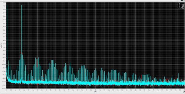

The results are:
0.030 % THD at 96 MHz and 0.033 THD at 72 MHz.
The differences were tiny, but consistently different between the two.
The cyan line shows the IMD (intermodulation distortion) with system clock at 96MHz, and red shows the distortion at 72 MHz.
Distortion products at about -70 dB from the fundamental is not great performance, but probably around what's expected for the SGTL5000.
My suspicion is that on a better DAC, the differences will become more apparent. It'll be interesting to see :)

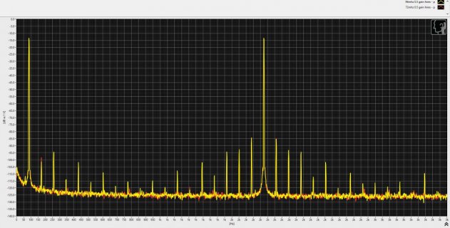

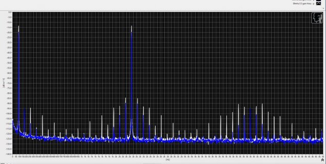

Here's the full spectrum for completeness.

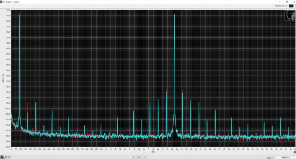

I checked your sine table, and at exact multiples of the fs/256 frequency, it was quite accurate. But I checked with the hires just to see, and the results are virtually identical. Very very minor differences:
This shows the 96MHz with the original sine, vs 96MHz with the hires sine:
And this shows the 96MHz hires sine vs 72 mhz hires sine:
Again, very tiny, inconsequential differences as far as I can see between 72 MHz and 96 Mhz.
I guess the MCLK jitter is just not a concern with this codec.
By bringing the gain down farther, the distortion goes down quite a bit, as seen in this graph. It shows 0.5 gain (nearly full scale output with 2 sine waves adding), vs 0.25 gain.

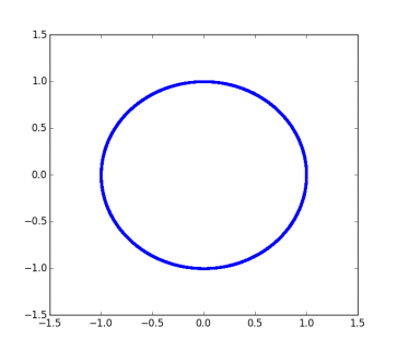

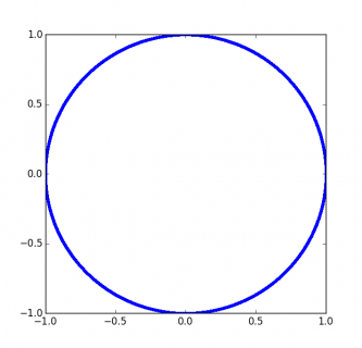

Here is some python code for you to play with
from numpy import *
from pylab import *
fs = 44100.0
frequency = 101.1 # some oddball frequency not a perfect multiple of fs.
state = complex64(1.0 + 1j*0) # use 32-bit floats
# compute this many samples
n = 100000
#      cycles/second      2*pi radians    radians
# w = ----------------- * ------------ = --------
#      samples / second    cycle          sample
w = frequency/fs * 2 * pi
phasor = complex64(cos(w) + 1j * sin(w))
output = zeros(n, dtype=complex)
output[0] = state
for i in range(1, n):
    output[i] = output[i-1] * phasor  # <--- python is handling the complex multiply for me
plot(real(output), imag(output))
show()

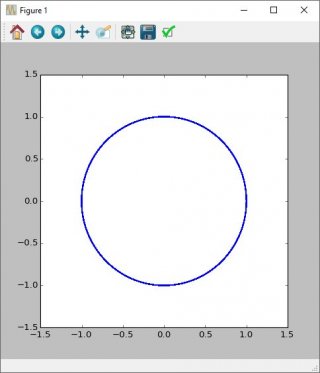

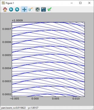

That produces a plot that looks like this:
Which if you zoom in closely on the line, you'll see is not quite a perfect circle:
Which is why you need to renormalize the length of the state vector back to unity once in a while. Perhaps once per block. Perhaps once per several blocks. With floating point you can obviously go a long time (100,000 samples) without renormalizing, but with fixed point, you need to renormalize more often.

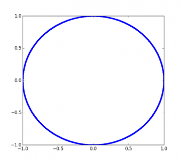

Here's a modified version that can simulate different fixed point numbers (badly).
from numpy import *
from pylab import *
fs = 44100.0
frequency = 12001 # some oddball frequency not a perfect multiple of fs.
state = complex(1.0 + 1j*0)
n = 1000000
phasor = complex(cos(w) + 1j * sin(w))
output[0] = state
digitize = float(1<<31)  # Simulate 32-bit ints
    o = output[i-1] * phasor
    #round to simulate 16-bits (or whatever value digitize represents)
    o = round(real(o)*digitize) + 1j*(round(imag(o)*digitize))
    o = o / digitize
    output[i] = o
print abs(output[0]), abs(output[-1])
plot(real(output), imag(output), ".")
show()
Here it is with no digitizing (doubles). Final length = 0.999999946968
And after 1 million samples at int32: final length = 0.999999946968.
I didn't realize 32-bit ints would be so accurate.
And after 1 million samples at int16: final length = 1.00001380443
So, it looks like you could even do this with 16-bit math and not have to renormalize very often.
-Caleb
