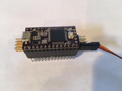

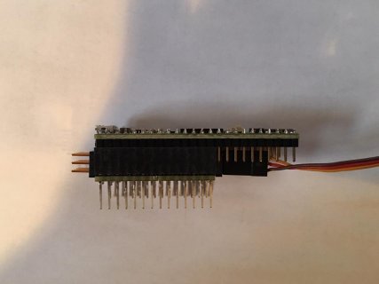

Hi Mike, thanks! The 3.5 and 3.6 will still work. Attached are a few photos of the SBUS backpack with a Teensy 3.2 and 3.6 with a servo connected. There's still enough clearance for everything.
I was considering the RFM69HCW for the 900 MHz / 433 MHz radios, I think the 3DR radios use the Si1000; I haven't done enough digging yet around these modules, which is why they aren't slated for the initial release set of backpacks.
Brian

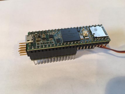

The Teensy 3.5 and 3.6 will fit on top of these boards, see below. If you have ideas for an adapter to integrate them more seamlessly, please let me know!
Brian

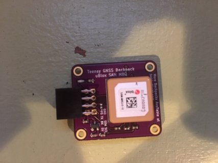

The uBlox SAM M8Q does not have an external antenna capability; however, I’ve designed the backpack so the receiver can be remote mounted.
OKAY, however, it should be no problem to substitute the uBlox Neo M8N-0-01 equipped breakout that I have (attached image), and use the external active antenna connector to take advantage of the vehicle roof-mounted GPS antenna that I have on my vehicle currently?
Shouldn't be a problem; if you connect via the stackable headers, you would want to connect GND to Teensy Ground, RX and TX to Serial3, and PPS to pin 14 (https://bolderflight.com/products/teensy/pinout/). Do you have a link to the breakout or a spec sheet? My biggest question would be whether to connect VCC to VIN or to 3.3V. If the breakout works with 5V, you could also connect to the GNSS receiver connector on the GNSS Backpack - all of the pins have labels and you would just match up the labels.
Please let me know if you would like a refund for the GNSS Backpack.

It *was* my hope to just use this BOB in place of the SAM M8Q and match pinouts across the gap to the GNSS backpack.
In the lower right of the photo, you can see a V-Reg, but not the marking (which happens to be 'DE=A1D'), but it is a 3.3V output LDO with the input pins routed to the 'VCC' input pin, so it's fine as far as VCC goes.
So, it is my assumption that, given the PPS, RXD, TXD, GND, and VCC pins on my BOB, I can then wire those as appropriate to the GNSS backpack, and go on my merry way.
Should I assume that your uBlox library will accommodate the M8N without a lot of hair-pulling, or should I start pulling my hair out now?
in stack order:
Naw...no refund on the backpack. Send that sucker. I'll use the M8Q in something around here.
Yes, that's a good assumption and how I would do that if I was in your situation. Should work great.

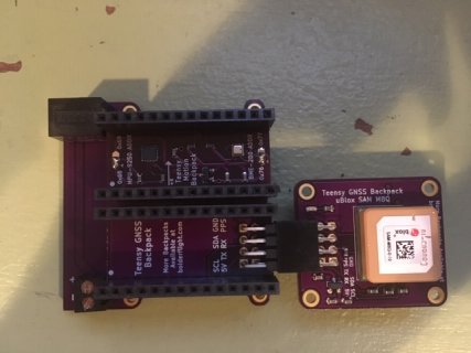

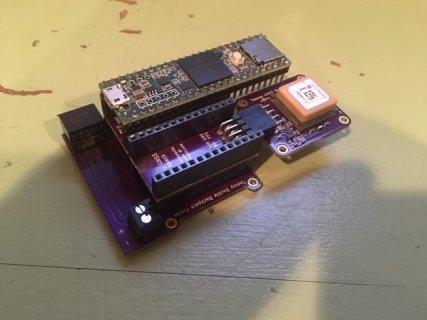

Hi Brian. Finally had a chance to try out my IMU backpack with the double frame. As expected works out of the box. Just tried it with the advanced i2c example. Now will try one of the Kalman filters :)
