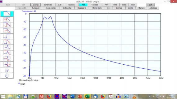

Hi Frank,
I have no experience with PIN diode switching, but they are said to have low resistance against IM3, which means that high signal levels can seriously distort your reception. Could be that you can improve that with higher voltages driving the diodes, but I cannot help with that due to my missing experience in that field.
Preselection for the Tayloe / QSD - SDR-frontend is tricky. You need at least 50dB attenuation at three times the Receive frequency and your filter passband should not attenuate too much. I have simulated one of the filters of the schematic you gave with ELSIE (using realistic Q values for SMD Ls [30] and SMD Cs[200]).
As you can see, attenuation at 3xRx freq is about 45dB [Rx = 7MHz, 3x = 21MHz], which could be enough! But you can also see, that in the centre of the passband, the passband attenuation is more than 7dB !!! That hardly acceptable from my point of view. And this is for a perfectly RF-optimized PCB design and does not take into account any effects of the diodes . . .
I doubt that we would need a bandpass, a lowpass should be enough (but should be able to provide >50dB of attenuation at 3x the Rx frequency), because the attenuation of the Tayloe frontend at 1/2, 1/3, 1/4 the Rx freq is much higher than at odd mutiples of the Rx freqs.
Have a look at this frontend [you would have to recalculate all the filter values for your desired input/antenna impedance, eg. 50 Ohms]:
https://www.box73.de/file_dl/bausaetze/DK5DN_FiFi-Preselektor.pdf
All the best,
