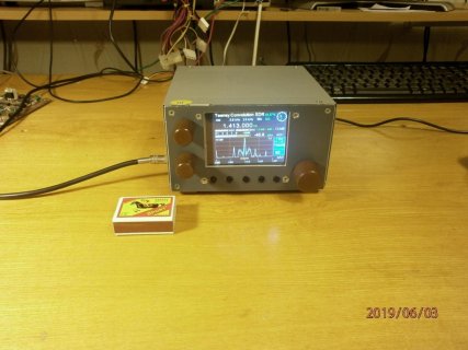

Frank, thanks for your reply!
It is very interesting to me why your compiled file does not work after loading, whereas with the compiled file from Wolfgang DH1AKF everything is fine, the receiver works very well.

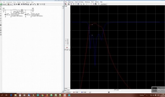

Frank, i tried RFSIM99 instead (I tried elsie but was not able to use it correctly) - and more important - the exact parts. You can see the parameters if you enter the inductor- partnumber in digikey. You can see the q-factor and resoance frequency, in the digikey result table.
The result is is a bit different:rfsim.jpg
Only -1.53 db, and the graph looks different. I read RFSim99 is very exact and gives reliable results.
Any thoughts? :) Have I done it correctly (I don't have experience with this stuff :) ??
The board will have the frontend only, including the filterbank.
I'm thinking about adding a MMIC amplifier beforethe filters.

Hi FrankB,
thanks a lot for your simulations of the input filter!
I am a little puzzled about that difference in comparison to my simulations with ELSIE . . .
Will have to think about that and try to simulate a little more.
However, I will be travelling the next four weeks, so not much time for that . . .
All the best,
Frank DD4WH
Hi Valeri,
well thats explainable:
* there are different options to use the oscillator chip Si5351: which clock output do you use? [CLK0, CLK1, CLK2] and which Xtal frequency did you install? [25MHz, 27MHz]
These six different options alone explain why a specifically compiled file works on your machine and the other does not.
That is exactly the reason why I would recommend to compile the ino. - file by yourself according to your needs! It is not so complicated as you might think [especially for a trained ham radio amateur ;-)]!
All the best,
Frank DD4WH
