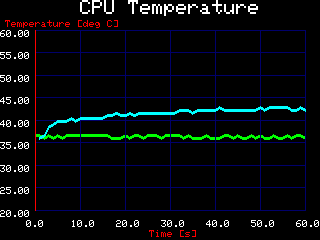

Interesting problem. FYI:
Changing CPU frequency on the fly in a vertically mounted socketed T4.1 results in a Time Constant of approx. 30 seconds. So it doesn't take long to see just Teensy effects.
24MHz CPU is about 11C above ambient
MHz     °C rise
24      11
528     21
600     23
912     31
Attached is a ILI9341_t3 screen dump. The ambient was 20C. The lower line is at 24Mhz after a few minutes. The upper shows when switching to 600Mhz a few seconds from left.
