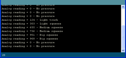

Adafruit's example code also won't work. It measures the resistance once per second. Even if you speed it up, this won't work. This image from their tutorial should illustrate why:
In this screenshot, a single squeeze resulted in 6 lines printing. If you speed it up, you'll get *many* more. Imagine this is really a musical event. You wouldn't want to send 6 MIDI messages. Your challenge will be figuring out code that waits long enough for the initial response to happen. In this case, maybe you'd ignore 124 and 303, but maybe by the time it's at 655 you'd conclude the initial touch has occurred and you want to send a Note On code with velocity. How well you write this code, to turn a flood of incoming data into the decision about the Note On event (and velocity) will be the main thing that determines how great your instrument ends up performing!
Then as time goes on, the touch becomes 901 and 968. Maybe you send aftertouch control messages. There too, you might want to pace yourself. The readings will come in much faster than meaningful human touch, and probably a lot faster than you'd want to flood a MIDI system with messages.

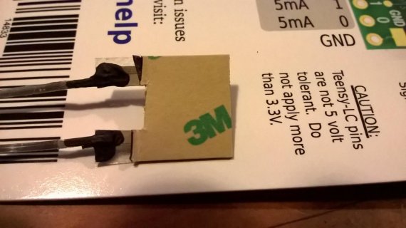

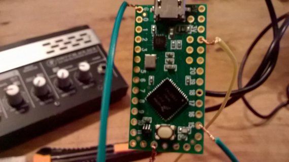

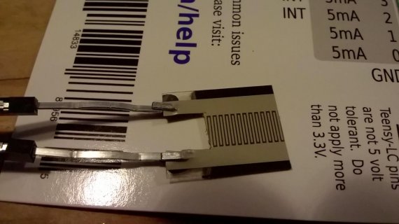

I made an fsr project, with poly aftertouch.... the best thing about it is cutting up one of these 24 inch fsrs into about 24 bits and making baby fsrs out of them cheap ... $1 a pop.
Here are some pictures ...
Basically you cut out the zigzag interlocking electrode part to create two electrode 'rails' (the grey plastic in the photos) ...You peel the backing off your new electrodes and manually shove a flattened out heavy duty staple (or other small bit of metal) through the grey part, crimp using pliers, and apply a bit of conductive glue (probably unnecessary) .... you can't solder directly to the fsr, but I guess you can solder to the staple, so long as you are quick (or solder before you shove them in!!) ...I used female breadboard wires myself...

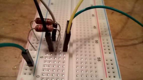

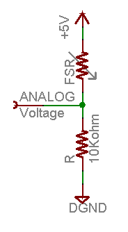

I used 15kohm resistors because thats what I had ...10k may be better, in the sense that it will give a different velocity curve, I think ... I didn't use any actuator pads or mount the fsrs properly (that would help with repeatability / stability) ...I just wanted to see how it would work ...
The circuit diagram (such as it is) is from adafruit. Here is a picture on the breadboard for 2 fsrs, and of the teensy LC I used ... (I used 3.3V btw, not 5V!)
force___flex_fsrpulldownsch.gifWP_20151220_21_01_16_Pro.jpgWP_20151220_21_00_09_Pro.jpg
