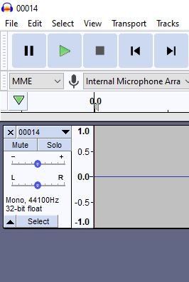

Teensy guestbook - No sound when play wav file on my computer
Hi everyone!
I am new here and I am with a problem with my project for weeks, any help will be appreciated.
I'm trying to make a guestbook with a rotary phone like that: https://www.youtube.com/watch?v=dI6ielrP1SE, my issue is that I can't hear audio when I play the wav, the file has size and the player time is running, I tried many things, I tested with 3 different microphones, connections look good, serial monitor look ok as well, the greeting message is ok. I don't know if I need a specific microphone or some connection is wrong, I really appreciate some help guys. If you need more information, images or any specific thing please let me know, since now thanks.
I am using teensy 4.0 and the audio board Rev D.
Code is here: https://github.com/playfultechnology/audio-guestbook/blob/main/audio-guestbook.ino

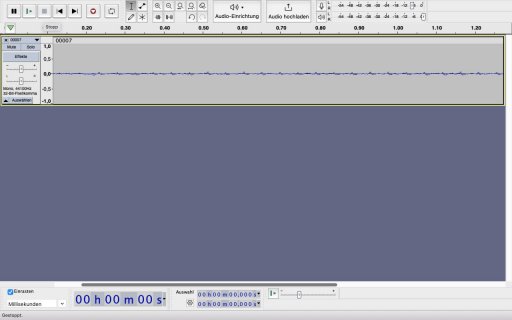

Post a WAV file that shows the problem? See Forum Rule at the top of every page you visit here ... "details to reproduce any issue".
One issue with DD4WH's fork, which I fixed and got pulled into the original repo, is that the WAV files have incorrect chunk lengths in them. I can get them to play on my PC, but that may be application-dependent.

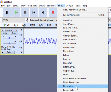

Or the record level may just be very low, and you're boosting the output enough to hear it on the phone, but not the PC. Take a look at the waveform in Audacity or similar.

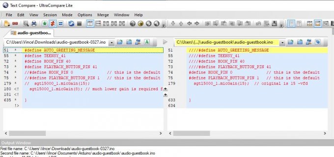

Thank you h4yn0nnym0u5e. New here -- didn't seem like my question needed my sketch (since it's all pretty much copy/paste) but I can do so next. For now I've imported a wav into Audacity and I see a flatline of audio. It sounded loud enough when played back on the phone.
But the bitrate is cofusing me. If I look at the file (00014.wav) properties with Windows Explorer it says bitrate is 705 kbps! The sketch says 'unsigned long sampleRate = 44100;' -- Audacity appears to show 44100 Hz (see image). Not sure if my recent library downloads included your chunk-length fixes.
Having lots of trouble trying to include a jpg image here. Where does it show up after attaching? :p Will also attempt to attach the 00014.wav file. Sorry, it's not letting me attach the wav file.

705kbps is correct: 44100 ksps = 88200 kBps = 705.6 kbps (k samples, bytes and bits per second).
No particular need to upload the sketch so long as you've tried an original one unmodified. If you modified it ... you may well have broken it. Use one source repository, and get it working, then make small changes and test as you go along. It's a recipe for failure to start by mixing and matching code from several repositories unless you know exactly what you're doing.
Thank you h4yn0nnym0u5e -- Learned something new today (the conversion of kbps from ksps)! I did the Insert Image thing (and upload of the .jpg file) but it didn't work. I'll try it again here for practice. Guess I'll diff my sketch with the repo to be sure I didn't break it.

That looks like a noisy example uploaded to the forum recently. Here it is before:
and now, after I got rid of a loud glitch at the end, then did Effect / Normalize:
Couldn't hear it before I did that...
EDIT: your code in post #6 doesn't have the chunk size fixes - they're near the start of writeOutHeader()
Sure thought I had it when I realized I was recording with the Teensy connected to my PC. So I recorded 00015.wav connected to an external power pack. Still no amplitude in the playback on my PC (the greeting.wav plays fine). Even though it wasn't a factor, the YOU CANNOT RECORD WHILE THE TELEPHONE IS PLUGGED INTO THE PC warning would be good to be placed near the head of audio-guestbook.ino. The attached diff of the current sketch (DD4WH) (left side) and my sketch (right), showing only differences, looks good to me. Will try to attach the wav file (zipped). And FWIW an image of the serial monitor when I plugged back into the PC.
Okay, none of this attach stuff is working (again) -- I'm pretty sure I'm running a current Chrome browser. Maybe I'm downlevel on Java? May fire up Edge and try from there...
Seems to be working with Edge.

Odd that you can't attach stuff, not much I can do to help with that! Could be a forum restriction on new joiners, is the only thing I can think of. Can you put the WAV on a DropBox or Google drive, with public access?
My code as pulled into the official repo is intended to mitigate the "can't record while plugged into the PC" restriction, though I can't say for sure it's 100% effective, there are just too many variables. The issue was some weirdness with the MTP, which took serious expertise (i.e. not me!) to diagnose. I'd have to go back to see if the next Teensyduino is likely to have a fix for that, but the mitigation won't hurt if it's left in, as the normal use case is using a power pack anyway.
If in doubt, the power pack option is best for overall quality and lack of glitches. However, it should not affect the level - you ought to get something, even if it's stuttering. So (near?) silence suggests a hardware problem. I've ordered some electret mics from eBay to play with, though they may not be representative of the ones people are actually using.
AH ... just noticed something ...
Way after all the other sgtl5000_1 initialisation stuff, there's a call sgtl5000_1.micGain(15); which changes the mic gain from the default 52dB to 15dB, so 37dB quieter. That's a lot. Try commenting that line out ... you may need to change the mixer gain and / or sgtl5000_1.volume() to avoid blowing your ears out on the phone. And the beep waveform level, too.
Okay, I cranked the mic gain up to 52 dB (thank you h4) -- and now the wav has good audio level -- including a terrible noise background! Now I need shielded audio mic lines? Can't do that in the "curly" cable coming from the handset! 00019.wav (zip attached) was done powered by the power pack and with audio tweaks set to "normal" -- with the tweaks enabled, the recording was very distorted (even at the low mic gain). It's unclear why original mic gain was 15 dB.

Hey guys,
I'm new to this forum, so if there is anything wrong - please let me know.
My english is not the best (especially when using techincal language)..
Last year I already built a phone which is working quite okay (first time "programming" and building something like this phone).
Now I wanted to make a second phone but have some issues with this one.
I have the same issue with my phone - not having sound when playing the wav file on my computer.
I changed the dB and tried different once as well and got some sound but not my recorded voice. It is more rushing(?) than anything else..
Even using the same code as used with my first phone does not help.
Do you have any ideas?
Thank you in advance
