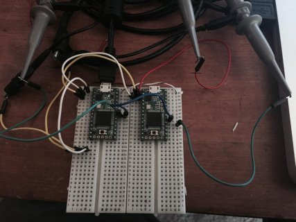

This is a pic of the setup I'm using: CTS is only available for Serial1 on pin 18 or 20 with the Teensy 3.1.

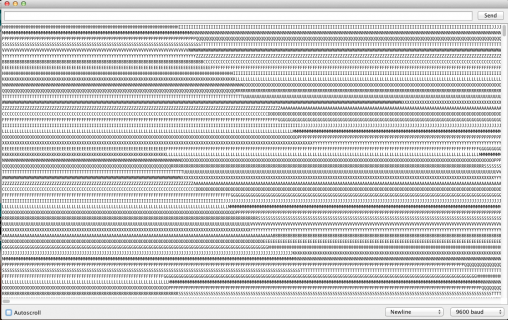

This is a pic of the data being printed to the Arduino Serial monitor without signaling Teensy 1 CTS, note: the data is not looking nice:

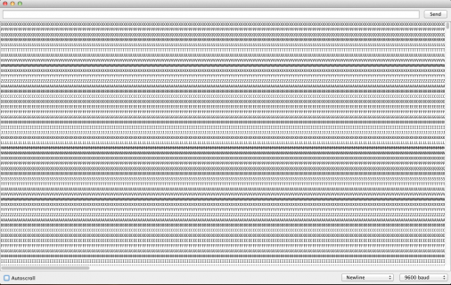

This is with CTS signaling, you can see the data looks nice now:
