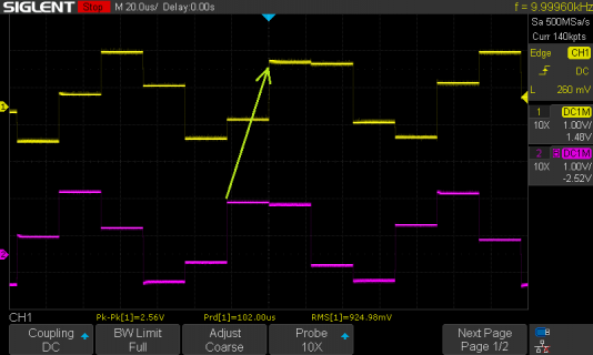

While checking the output signals on the oscilloscope I noticed that the left channel [yellow] is trailing behind by 1 BCLK period when sending out a mono 10kHz sine on both channels:
By the way, on a Teensy 3.2. [at 4x oversampling], the left channel is also trailing behind by 1 BCLK period:
Is this a property of the PT8211? Or is this perhaps code related?

I think this is due to the inner working of the PT8211. It has no MCLK that other chips may use for this purpose?
It is a cheap, cost optimized product, as well as the Teensy LC CPU. Freescales calls it "ultra low-end microcontroller" in the reference manual :)
I wonder how they would call the ATMEL 8-Bit products.
The PT8211 datasheet is here: https://www.futurlec.com/Datasheet/Others/PT8211.pdf
On the scope, for me, the timining looks like as required. Or, maybe you want to look at it? YOu can cheat a bit and comment-out "interleave" in the ISRs and replace the memsets at the beginning with a loop that fills both channels with 0x01. This way its more easy to verify the timing.

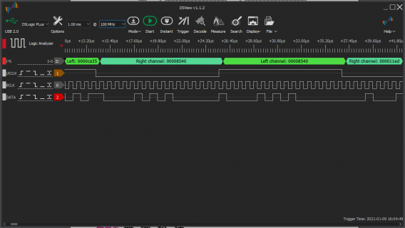

Here is what the logic analyzer shows:
Identical data for right & left 16 bit sample, 0x00008540.

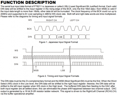

Timing of the I2S frame is according to the datasheet of the PT8211:
Data is sampled on the rising edge of BCLK.
From the paragraph below the figures: "The buffered DIN data then feeding to the DAC after both input register are all settled down, this can eliminated the phase shift happened between two channel output."
Well, the phase shift is unfortunately not eliminated - it's off by 1 BLCK period.
Paul

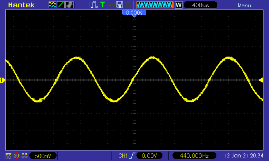

SGTL-5000 sine (44116,9739Hz sample frequency):
However, I need to find a way, NOT to initialize the SGTL-5000 after a reset. Otherwise it stays silent...
