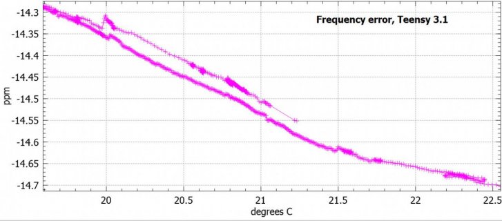

The below code assumes a system clock frequency of 48 MHz. It takes a 1-PPS signal input from a GPS, and ambient temperature as an analog level from an LM35 sensor, and averages readings over 60 seconds to calculate the absolute error in PPM of the crystal relative to the assumed-correct 1 PPS input signal. Plotting the output over some temperature range allows calculation of ppm/C drift. A few boards I measured are below. I am sure the measured variation is everything to do with the particular crystal, and nothing to do with the particular device. "garden variety" CPU crystals are usually only guaranteed to be within +/- 100 ppm absolute and often have no particular temperature tolerance specified, so all three tested units look fine to me in this regard.
T3.0: -4.21 ppm @ 20.2 C, -0.138 ppm/C
T3.1: -14.47 ppm @ 21.0 C, -0.156 ppm/C
T_LC: +16.9 ppm @ 19.58 C, -0.309 ppm/C
Rdg , degC , ppm
# from Teensy 3.1
1 , 21.3820 , -14.555
2 , 21.3966 , -14.559
3 , 21.4091 , -14.563
4 , 21.4212 , -14.564
5 , 21.4327 , -14.563
6 , 21.4452 , -14.568
7 , 21.4583 , -14.569
8 , 21.4705 , -14.570
9 , 21.4828 , -14.574
10 , 21.4956 , -14.575
Rdg , degC , ppm
# from Teensy LC (green beta)
Rdg , degC , ppm
1 , 21.5658 , 16.222
2 , 21.5536 , 16.223
3 , 21.5441 , 16.228
4 , 21.5399 , 16.230
5 , 21.5323 , 16.233
6 , 21.5278 , 16.234
7 , 21.5255 , 16.235
8 , 21.5238 , 16.236
9 , 21.5215 , 16.235
10 , 21.5234 , 16.236
// based on PaulS's FreqMeasure for Teensy example
// Digital Input: 1 PPS signal : on Teensy LC: Pin 16  on Teensy 3/3.1: Pin 3
//  Analog Input: 10 mV/degC temp from LM35 : Analog 1
#include <FreqMeasure.h>
#define TEMP_IN A1           // analog input with 10 mV/deg.C from LM35 temp sensor
#define AVERAGES 60          // how many input pulses to integrate over
//#define VREF (3.316)         // Teensy LC ADC reference voltage (= Vdd power supply)
#define VREF (1.2)         // Teensy 3.0/3.1 ADC internal reference voltage
#define ADCMAX (65535)       // maximum possible reading from ADC
#define NOMCOUNT (48000000)  // nominal oscillator frequency count
#define NOMCM (48)           // nominal count divided by 1E6 (for ppm calculation)
  pinMode(TEMP_IN,INPUT);
  analogReference(INTERNAL);  // set analog reference to internal ref
//  analogReference(EXTERNAL);  // set analog reference to external
  analogReadRes(16);          // Teensy: set ADC resolution to this many bits
  analogReadAveraging(16);    // average this many readings
  FreqMeasure.begin();
double sum=0;
double ppm;  // frequency error in ppm
int count=0;
unsigned long lastT = 0;
unsigned long deltaT;
unsigned long newT;
unsigned long reading = 0;  // how many measurements we've reported
boolean firstTime = true;
double x=0; // analog temperature reading (LM35)
unsigned long tsamp=0;  // how many temperature readings we've done
long fcount;  // raw frequency count value
  if (FreqMeasure.available()) {
    newT = micros();
    fcount = FreqMeasure.read();
    // Serial.println(fcount);
    sum = sum + (fcount - (NOMCOUNT));
    count = count + 1;
    if (count >= AVERAGES) {
      deltaT = newT - lastT;
      lastT = newT;
      if (firstTime) {
        firstTime = false;
        Serial.println("Rdg , degC , ppm");
        ppm = sum / (NOMCM * AVERAGES);
        x /= tsamp;
        float degC = 100 * (VREF/ADCMAX)*x; // LM35 temp sensor = 10 mV/C
        float freq = FreqMeasure.countToFrequency(sum / count);
        reading++;
        Serial.print(reading);       Serial.print(" , ");
        Serial.print(degC,4);        Serial.print(" , ");
        Serial.print(ppm,3);
      sum = 0;
      count = 0;
      x = 0;
      tsamp = 0;
    x += analogRead(TEMP_IN);
    tsamp++;
} // end loop()
