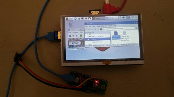

You need to actually compile the Arduino sketch on a PC or Mac. Sorry, there isn't any working support to compile using Arduino actually running on Raspberry Pi.
Once you've compiled (eg, click "Verify" in Arduino), you can copy the .hex file to your Rapsberry Pi. You can run Teensy Loader on Rapsberry Pi to actually program it onto your Teensy.
