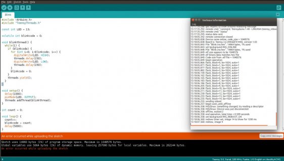

So something strange happened, when i had verbose open the loader was uploading without "not responding". The IDE was reporting that "an error occured while uploading the sketch" but the sketch had been uploaded (i know because i chose the blink example). I tried to make it not respond and i succeed, (same message at the IDE) this is the screenshot with the verbose open: Selection_001.jpg

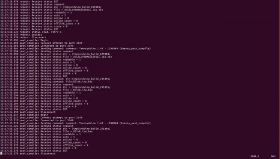

And the teensy log (it stops there,it does go after 13:17:35.270 ):
My best guess from this log info is your PC sent the request to Teensy to reboot around 13:17:35, and Teensy did indeed reboot to bootloader mode.
However, it seems the Linux kernel cdc_acm driver was still trying to use the disconnected device. This line is the really suspicious part...
Jan 22 13:18:05 Bomba kernel: [11107.111610] cdc_acm 2-2:1.0: failed to set dtr/rts
...partly because the cdc_acm driver should not have continued trying to set dtr/rts on a disconnected device, and partly because it happened exactly 30 seconds after the disconnect. That's almost certainly some sort of things-have-gone-very-wrong timeout within the Linux kernel. Then the kernel detects Teensy has appeared again as the bootloader HID IDs (16C0/0478), but right after the cdc_acm driver finally gives up an operation it should have aborted 29.9x seconds earlier!
I can tell you with confidence Teensy didn't take 30 seconds to reboot into bootloader mode. It was almost certainly sitting there from 13:17:36 to 13:18:05 just waiting for your PC to start the "usb enumeration" process. The kernel really should have detected new device arrival and HID 16C0/0478 much sooner, like around 13:17:36.
Something certainly looks messed up with how your kernel is handling USB disconnect and alerting its drivers. Which distro and which kernel version is this? I have used Linux quite extensively for USB over the last 10 years. I've found a few kernel bugs (especially in the early days of the hidraw driver), but this is unlike anything I've seen before.

Problem: I am allowed to upload as long as I press the "Button" on the teensy. If I do not the arduino IDE will throw an error.
Through matlab I can see that the teensy port is instantly occupied when connected to my laptop
Unable to open /dev/ttyACM0 for reboot request
Teensy did not respond to a USB-based request to enter program mode.
An error occurred while uploading the sketch
This problem stated when I upgrade my Ubuntu version :(
