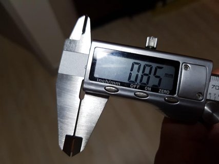

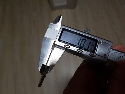

I'm posting this here as well as the Sparkfun forum, because I feel I'll get more response here. Has anyone who regularly uses Teensy MicroMods noticed that some are difficult to push into the M.2 connector? I received one and measured its thickness. It is 1mm. Others are 0.8mm - this conforms to the M.2 spec - 0.8mm +/-10%. I'm guessing this is to add rigidity because of the failures we widely discussed and complained about. It's difficult to insert into the connector and more prone to bending when screwed down. Oh well... This post is just a complaint really.

Hmm. thanks for the heads up. 0.15mm thicker is only like 0.005" which is maybe the thickness of a sheet of paper but still that would certainly create a bigger problem with inserting them. I wonder if it provides a tighter, long lasting fit or if this could damage the M.2 slot?

Also 1.0mm is 25% bigger than 0.8mm ... more bend from prying across the connector sounds perhaps counter productive.
One thing to note is that 1.0mm is very nearly _twice_ as stiff as 0.8mm, so its a massive difference in robustness.
Screwing the thicker MicroMod down requires more force and it's this that worries me.

I welcome the stiffer MicroMod. The one I have bends alarmingly when in use; MLCCs and BGA pads really do require a stiff board or problems ensue (as we've already discovered with the MicroMod pad issues).

Sparkfun's answer is to send it back to Digikey. They're not going to address how or why it's happened (an obvious increase in board thickness done by their manufacturer). This underlines why I would trust a similar product from PJRC.
