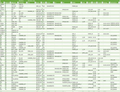

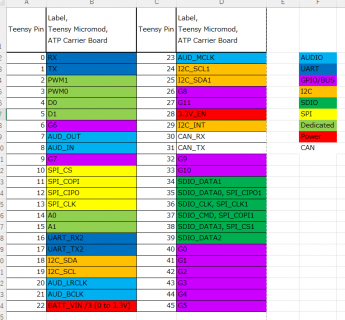

I have a theoretical question for you about the teensy micormod card.
We agree that there is only need to connect pins V_USB, USB_D-, USB_D+ and GND to detect the card on the pc ?
If you're theoretically asking about the MicroMod card without the carrier board, you also need to connect 3.3V. The actual MicroMod card doesn't have the 3.3V regulator. It depends on the carrier board to get it 3.3V power. There are two 3.3V pins and many GND pins. While it would probably work if you connect just 1 of each, it's really meant for all the 3.3V pins to connect to the same power and all the GND pins to connect to ground on the carrier board.
If you're asking about the combination of MicroMod plus carrier, then yes, only those wires from a normal USB2 cable are needed.
