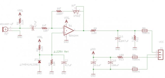

I've started work on a simple adaptation of the SparkFun Microphone Breakout board. Same basic design with three changes:
1) Bulk cap on the 3.3V supply - cause more is better
2) Added a 1.2V precision reference to get the bias voltage down to 0.6V (versus half supply)
3) Added 0.2 inches to the board length to accommodate the new parts.
If you have time, please share your thoughts on the design. Eagle files here:
https://www.dropbox.com/sh/960lqz5ub5nsx24/AAAl_404IylyiDKQwaTezwT1a?dl=0
Thanks!
-Leon

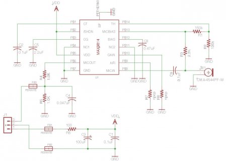

Nice part - I'll start an alternate design and see how it lays out. On the bias, I'm having a bit of a brain-block here, but why couldn't we simply add a resistor divider on the output to cut the 1.24V normal idle voltage in half? As the part output swings from 3mV to 2450mV, the 1/2 divider would go from 1.5mV to 1.225mV, centered at 620mV. It's got a 50 ohm output impedance, so we could drive a couple of 1K ohm resistors no problem. There has to be something I'm missing - need coffee!

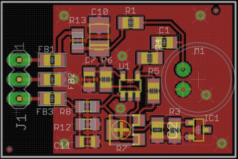

Quick update - working on the two designs in parallel - the simple Sparkfun derivative based on an op-amp and an Adafruit derivative based on the MAX9814. My Sparkfun microphones came in and I tried the simple R-divider on the output to get the midpoint to 0.6V. Works fine. Still dealing with Teensy digital noise getting in the analog gain chain, so I'm experimenting with power in and audio out filters.
It's a little on the large side - 0.8" x 1.3" (large postage stamp) so I'm still working on it.
Does FB2 help or hinder? Testing stand-alone is one thing, but this really should be tested in a harsh scenario, like where many WS2812B or APA102 LEDs are being used, or PWM is driving a motor, or RC servo motors are moving. Isolating the grounds when the ADC signal is ground referenced might be more harmful than any reduction of noise to the preamp helps. Maybe?
Likewise, does FB3 cause the ADC to make worse measurements? It generally needs a low impedance at high frequency, since it rapidly switches a capacitor inside the chip to make the measurement.
Just for the sake of low impedance driving the ADC, I have a clear preference for a design like in #1 where an opamp drives the ADC directly. But in that design, there should perhaps be a filtering for the microphone bias by adding a 100R + 10uF before R1.

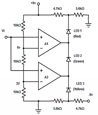

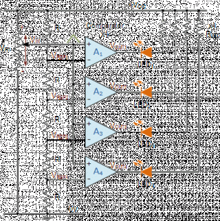

It would add quite a bit to the cost & size, but a little 4 to 6 LED level meter to assist with adjusting the gain pot would be a great feature. Ideally, the level meter should have a visual peak holding feature, where the LED for a brief peak stays on for a 10th of a second or so.
Driving a little 4 to 6 LED level meter with peak holding feature and a peak LED could be done by the Teensy, using the raw ADC data. In that way, it would cost less (out of a few I/O pins, resistors and LEDs) and it would be optional for those who want it.
Paul - agree! The inductors are 2500ohms at 70MHz and less than an ohm in the audio band. Hopefully they don't get in the way but if they do, I'll drop in 0-ohm resistors.
ACG - we should be able to defeat it via the external components. I'll read up more on that.
LEDs - great idea but I'm concerned about size and digital noise. I've used the LM3914/3915 10-segment LED bargraph display drivers in the past and love those things - simple to use and all analog. But they are only available in the large DIP package and would double the size. Any suggestions on similar chips? Otherwise, a small comparator circuit that drives an RGB led might be possible. Green below 0.6Vp-p, yellow up to 0.8Vp-p and red above 0.8Vp-p. Thresholds TBD.
Found this via Google. Red/Yellow/Green good enough??
Or - 4 levels:

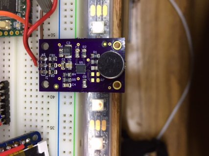

Status: The boards are due in from OSHPark next week. Components are already in so I should have some built in a couple of weeks, max.
First analog-version board built:
1) Changed 100 ohm resistor from 3.3V to mic board to 1 ohm - was getting oscillation on the power supply
2) Changed the two inductors on the Ground and Output to zero ohm resistors
https://youtu.be/PwyCAnzQNIo
https://youtu.be/lwbg7Gb1XIw
Still getting occasional bursts of noise on the 3.3V that punches through my simple filter AND I need to get some Neopixels hooked up to see their impact. More testing to come.

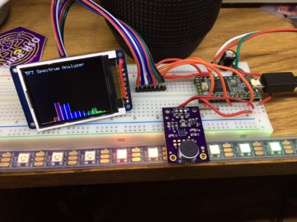

First MAX9814-based microphone built and wow, does this work nice!
1) Changed 3.3V power input resistor to 1ohm - same as analog version
2) Changed the two inductors on ground and output to zero ohm resistors - same as analog version
In addition to the LCD, I added a string of 45 Neopixels to test for noise. I have the LEDs running right under the microphone.
https://youtu.be/kaBH-RVNdoU
https://youtu.be/b0YMftwrT4o
The filtered power is rock steady and mic performance seems great. Soldering that MAX9814 IC sucks a bit so building more will take time but I think I'll build up 8 to 10 of these and send them out for people to play with. Let me know if you have time to test in your project.

FB1 is still that high-value inductor to hopefully knock any clock noise off the 3.3V line. I only have a 60MHz scope, so I won't be able to see anything too fast but based on what I seen so far, no issues.
I did solder it by hand. I placed a dot of low-temp solder paste on each pad and the center pad, placed the part and heated it up with a small heat gun until the solder reflowed. I then went back around and added a small amount of paste to those pads that looked light on solder and touched them up with a very pointy tip soldering iron.
