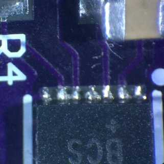

Yep - bad soldering job! I confirmed a wonky output and discovered a whole pile of solder balls between some pins. Heat it with the heat gun for a few seconds and it's back working again. FullSizeRender.jpg
They are kind of tough to see in the picture but between the last few pins on the left side, you can see some gray lumpy stuff. Those aren't suppose to be there!!

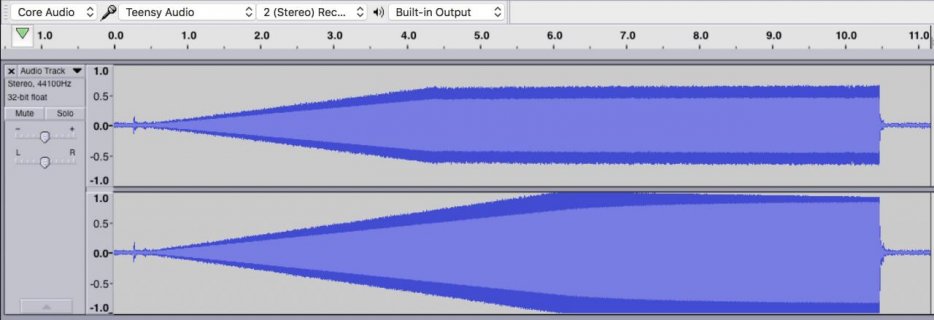

A quick test of the Auto Gain Control circuit. Top waveform has it enabled and the bottom has it defeated by shorting out a level set resistor. Based on popular feedback, I need to add a convenient way to shut that AGC off.
