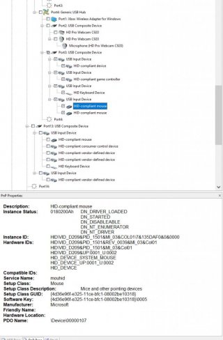

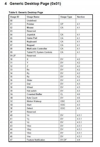

The issue is not in the input as it's consistent when you look back at the log, the values are sequential, and consistent. The issue is how the input is perceived by applications X and Y are smooth and operate like mouse wheels, Z/ Scroll Wheel seems to be more buffered or more jerky... which for a mouse wheel would make sense, you're scrolling so you want some lines to be skipped to make scrolling faster. But it's throwing software that needs this as a 3'rd encoder like Mame Etc... The result is that it judders all over the place, now to eliminate this I moved the encoders around, and the problem stuck with blue, I then moved the wiring and whatever was connected to the mouse scroll wheel input was misbehaving no matter the physical connections or encoder. I tried this with a 3.2 first and then with the QuadEncoder.h library and the result is the same.
So the constant is the mouse input, not what's driving the value, or how it's wired.
I'd add a second teensy, but then I have to deal with identifying which mouse and axis is driving what. I'd also have 3 devices driving the x axis, the mouse and 2 teensy's, I suspect that the scroll wheel is configured differently in Teensy or the HID where this occurs. As I have turned off all mouse acceleration, it's possible the scroll wheel deals with an internal acceleration factor.
