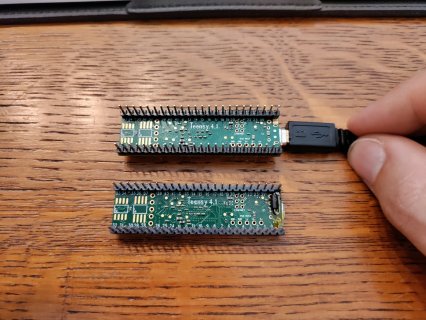

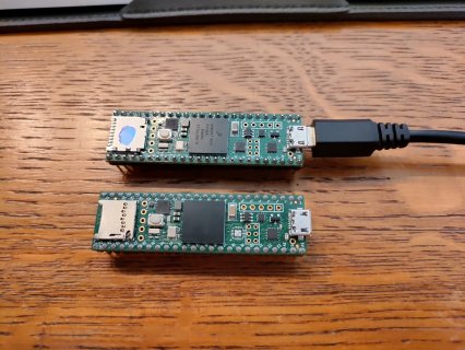

You can also find pictures of the working and dead T4.1 (Black USB cable connected to it). I still have exactly the same behaviour as in my first message:
  • The Teensy no longer shows up in the Arduino IDE (nor in the Device Manager).
  • I held the button down for about 10 seconds - the LED next to the USB port turned on, and then the Blink sketch started running.
  • I tried plugging it in using a different micro USB cable, but it didn’t help. Another Teensy 4.1 works fine with the same cable and is correctly detected by my computer, and I can upload code to it without any issues.
  • The board still receives 5V, and I also measure 3.3V output from the regulator.
  • The same code (quite confidential - I can't post it directly here) is running without any noticeable issue on the other Teensy and was running on it before.

This may be a dumb question, but when you're testing with a known good cable, is the cable plugged directly into Teensy's USB connector? And if so, are those non-USB white and green wires still soldered to the bottom side during the test?
I'm also curious what this part is on the bottom side? Or really, my question is whether it is making metal contact to the 2 bottom side USB signals?
Yes, same setup as the pictures attached to this message:
No, I removed them (see pictures previous message).
It's a low V_f diode. I put kapton tape under it to only leave the 5V and VUSB pads apparent to avoid shorting anything accidentally. This is the working Teensy so I'm not worried about it
