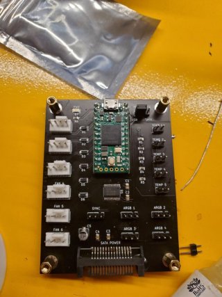

I designed a PCB similar to the one made here but with mostly SMDs, a SATA power connector and a level shifter IC to incorporate ARGB. That project looks pretty cool because it has a GUI for setup and everything. I've tried to compile that Teensy firmware but ran into issues, plus support for Teensy4 doesn't exist there. I also ultimately want to have this work with OpenRGB, for well....setting up RGB.
I'm gonna setup a git repo when I get a chance with board files and such. I'm wondering if I can get anyone interested in helping with code for it. I can whip up a couple of PCBs (minus the Teensy) for anyone legitimately interested in helping. I've thrown a couple of example projects at it just to test the board and the RGB, PWM, tach feedback, and analog thermocouple inputs seem to work fine. I used these for testing:
https://dev.kprod.net/arduino-pid-pwm-fan
https://github.com/rstephan/TPM2
The specs of what I have are:
5 thermocouple inputs
6 individual 4 pin fan headers
4 ARGB channels
1 ARGB sync channel (not sure if it's useful yet)
The board:

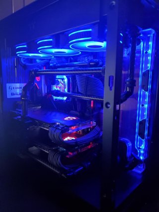

Where I plan to put it
