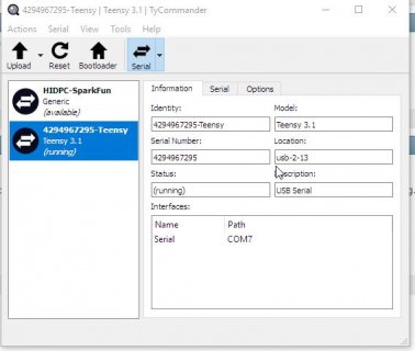

Ok, took a screen shot of the TYcommander and the PCA.. IMG_20180424_120606.jpgScreenShot001.jpg
Under tools menu is show application log - copy the text from that to a text file and post that.

This seems to be a problem on my computer Windows 10 Pro 64 Bit. On a windows 7 it shows correctly.. I will dig into this more to find out what is different.
Just for reference on my Win 10 Pro x64 machine.
I started TyCommander without the K66 Proto Teensy 3.6 plugged in. I opened the app log - Full view. There was some noise about 'Portname'. I hit CLEAR because I had another Teensy online and to clear that noise.
I then plugged in the PJRC K66 Proto device - which also came with no Serial number. This device was properly registered as a T_3.6 and this text appeared in the log:

I thought I'd see a note in the log text about the Teensy type by ID number - but I don't recognize it. Koromix enabled it in a debug build for me perhaps so I could tell him since he did not have a T_3.6 board at that time. I'm not sure where that value comes from - but there is unique a byte ID indicating which Teensy is connected. Somehow your board is not getting that right.

The boards on a windows 7 get the teensy 3.5 correct. Do not know why this computer does not. I have a laptop and will check it on that. it is also windows 10 64bit.. Lets see what it shows tomorrow.

@Wayne: The board model can only be identified while the Teensy is in bootloader mode. TyCommander keeps the serial <=> model information in cache to remember it.
If the cache is wrong, you can reset it in several ways:
- simply reboot the device, using the button (if your board has it) or the reset (or reboot) button in TyCommander,
- or click on Tools > Reset Application.
The full log will show you the model ID when you run the Teensy bootloader, it should look something like 'Identified 'Teensy ?' with usage value 0x??".

- Detect Teensy model without bootloader (if built with Teensyduino 1.42+) with bcdDevice field
- Fix support for Teensy 3.5 firmwares compiled with Teensyduino 1.42+ (with RAM = 256K)

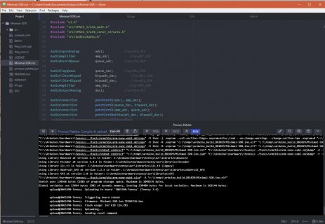

Just found a good way to compile sketches with Atom, with the "Process-Palette" plugin. Took 30 Minutes to figure out how it works. I have a nice compiler-window, like in Arduino now :) The only missing part is a Atom hotkey to upload the sketch with TY. Tomorrow (too late here)
Finaly: Goodbye Arduino GUI.
Upload done :) I love TYQT :)
Looks like this:
Nice, isn't it? Compiler output at the bottom. When errors occur, an extra window opens - not as messy as Arduino.
And the best is - no makefiles, but the original builder, so it is 100% compatible.
At the moment this still runs via a batchfile I wrote, which might have to adjust per project - if I feel like it, I'll make a nice menu for the settings (teensy model etc.) at some point.

Many thanks for the Batch script. I'm feel I'm close to my dream of using Sublime Text3 in place of the Arduino IDE.
The Sublime Minimap and Find functions I see as a real plus for projects that span multiple .ino and multiple libraries. I like the Compare Side-by-Side plugin alot also.
I tried Stino--2017 the Arduino-like plugin but failed once I got to my more complicated projects, so I ditched using this and have been trying to get Frank's Batch file to work.
However the .cmd batch is failing to fully build, with what looks like one or two wrong or missing libs, but builds successfully with Arduino (1.8.8 with Teensyduino 1.45 and TyComm 0.8.10)
I have tried to follow to build process, watching the build and staging folders, but I don't yet follow, let alone understand the process.
Any suggestions on how the Batch-file might build different to Arduino? Is it possible the batch doesn't dig as deep in the libraries or needs a slightly more structured/standard folder heirarchy?
Suggestion much appreciated. Output from compile below.
Many thanks.
