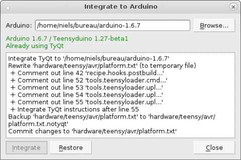

- Add Arduino integration dialog

- Support integration to legacy Arduino (1.0.x)

With 0.7.0 I will release instructions to integrate it with the IDE and replace Teensy Loader. If all goes well, this integration will upload to the selected board in the IDE (in Serial mode), or provide a board selection dialog on first sketch upload for the other modes.

I've uploaded a new build with the poetic name TyQt-0.6.3-199-g81d2743. It features a new Arduino integration dialog, accessible under "Help > Integrate to Arduino". It will replace the Teensy Loader with TyQt, or do the reverse with a single button.
