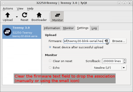

Koromix: Now using TYQT as the 'Loader' - One issue I have created is I'll be writing the same sketch from the same IDE instance to either of two (or 3 or 4) Teensy units. Once TYQT associates an IDE with a Teensy it doesn't ask where to put it - this was the problem with Teensyloader. In my case the sketch will determine at runtime which Teensy it is on so I'll want the same HEX on each unit - not always the same unit. Is there a way to break the 'remembered TYQT association' without having to 'Export compiled binary' and use a directed upload to each Teensy?
