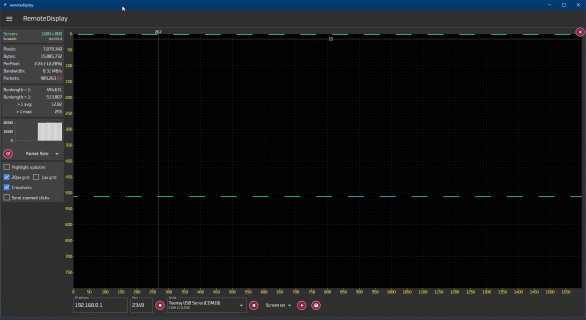

Thanks for sharing. Used this utility to make a very very very cheap oscilloscope.
