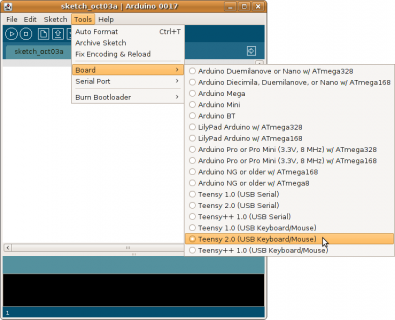

One more question - I'm new to the Teensy. Does the MIDI code work equally well on the Teensy 2.0 and the 3.1? I see the schematic with the 74HC4051 input multiplexer shows the 2.0 version....
Based on this image from the tutorial, which shows only Teensy 2.x versions and no 3.x version, I'm going to assume that only the Teensy 2.x versions are usable with the TeensyDuino and thus the USB MIDI library
The screenshots in that tutorial predate the introduction of Teensy 3.x, and so show the state of the Teensyduino at that time. USB MIDI can be used with Teensy 2.0, Teensy++ 2.0, Teensy 3.0, and Teensy 3.1.
Also, since that screenshot was taken, the selection of USB type has moved to a separate menu item than selecting the board. This makes it less cluttered.

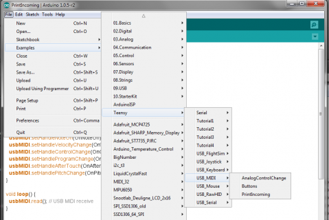

You can see some examples of USB MIDI in File > Examples.

I loaded the Buttons sketch in the Arduino IDE and uploaded it. I was happy to see "Teensy MIDI" appearing as new MIDI in and MIDI out devices.
