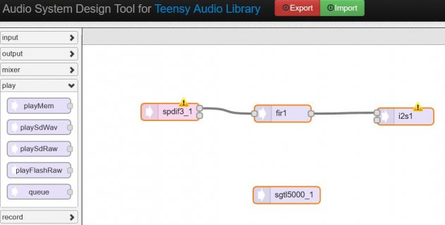

I am an experienced Arduino user but I am a beginner with Teensy, as I have not yet used a Teensy board.
I have this project on my table, and I need your expertise to know of it is possible (recommanded) to achieve it using a Teensy 4.1 (maybe Teensy 4.1 is not powerful enough and I should use a more DSP oriented chip ?).
My project is to used a Teensy 4.1 as a DSP, that will perform a F.I.R. filter prior a DAC.
Please find attached a quick diagram of what I would like to achieve.
Do you know if somebody has already achieved a similar project starting from a SPDIF input and going to an external audio DAC ?
Do you have any examples of a SPDIF / DSP / DAC project ?
Thank you very much for your help,
