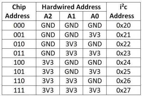

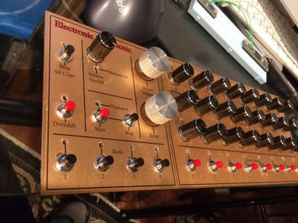

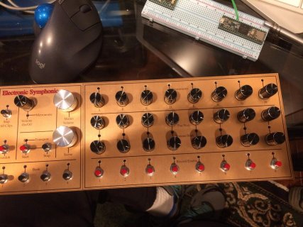

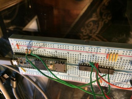

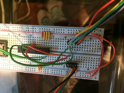

I am working on a project that has me reading 25 rotary encoders with buttons, controlling 32 LEDs, reading 16 "stand alone" buttons and reading 2 potentiometers. That makes a total of 127 inputs. I thought about using multiple Teensy's but that would be a lot of Teensy's so think I can make it work with 8 MCP23017's.

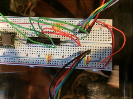

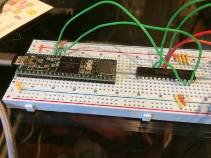

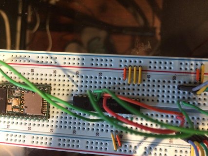

Bread boarding a prototype to test how the MCP23017's would work out I have run into a strange problem that has to do with addressing the Multiplexers.
When I set the MCP to address 27 (both on the bread board, 3.3v to pins 15,16,17 and in the code) everything seems to work OK. When I set the address to any other address (example: 20, GND pins 15,16,17) , it doesn't.
I only have 2 encoders attached at this time so wonder if this may be the problem ( I seem to remember you might need to set the unused data pins to Gnd or 3.3v, can't remember which, so they aren't floating)??? But it still doesn't make sense that it works on address 27 and not on address 20.
I have tested this on both and LC and a 3.6 with the same results. I have also swapped out the MCP, just in case that was the problem.
Pictures for the bread board wiring and a picture of the prototype panel.
Here is the code. I know it could be written better, but it works, at least on address 27. I also know I probably should be using interrupts, but I can't figure out how to code them.
