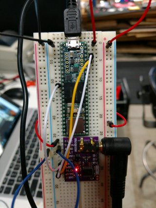

Hello,
I purchased an inexpensive PCM5102a module from ebay.
I put a teensy on a breadboard with it, and connected it using the information on this page
https://www.pjrc.com/teensy/td_libs_AudioOutputI2S.html
I used this code to hopefully passthrough the USB->I2S
#include <SerialFlash.h>
AudioInputUSB            usb1;           //xy=200,69  (must set Tools > USB Type to Audio)
AudioOutputI2S           i2s1;           //xy=365,94
AudioConnection          patchCord1(usb1, 0, i2s1, 0);
AudioConnection          patchCord2(usb1, 1, i2s1, 1);
AudioControlSGTL5000     sgtl5000_1;     //xy=302,184
  AudioMemory(12);
  delay(100);

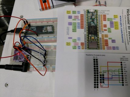

Here is the breadboard
I'm relatively new to this, but I had great success wiring up an Audio Shield to the teensy and proving my application. The above situation is not working. Does anyone have any advice on what I should do to get this to work? Could it be the "long i2s lines" issue? I don't know how much shorter I can get.
Thanks for your help.
Jay

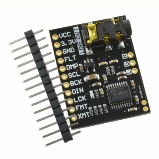

Update: I figured it out.
PCM5102A / Teensy 3.6
VCC = Vin
3.3v = NC
GND = GND
FLT = GND
SCL = GND (also works connected to 11 /MCL)
BCK = BCK (9)
DIN = TX (22)
LCK = LCRLK (23)
FMT = GND
XMT = 3.3V (HIGH)
There is a noticeable difference in sound quality over my PC port or audio shield.
And now I'm going to work on getting the ADC working. I'll post my results when I know.

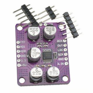

I got the ADC working now too on my project. It's a PCM1808 module, another cheap board from ebay.
Here are the connections for the PCM1808 module.
FMT = GND
MD1 = GND
MD0 = GND
GND = GND
3.3V = 3.3V
5V = VIN
BCK = BCK (9)
OUT = RX (13)
LRC = LRCLK (23)
SCK = MCL (11)
GND = GND
3.3V = 3.3V

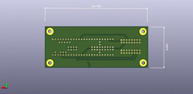

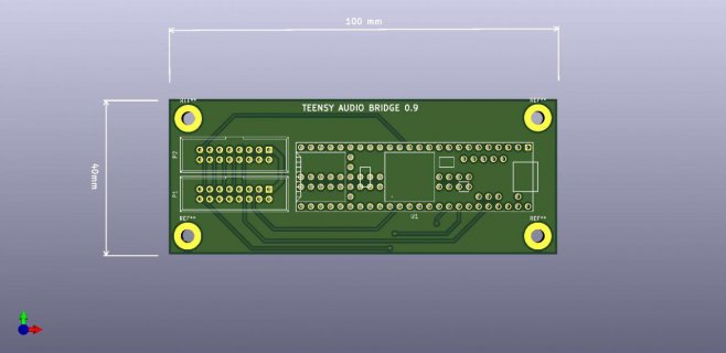

Hello Teensy,
Would it make sense to create a Teensy Audio Bridge? Would anyone else be interested in that?
From my experience with my project, and digital audio projects in general it seems that there should be some type of standardized connector for I2C/I2S Audio Connections. From my initial analysis, it appears that the Teensy 3.6 could have 4+ I2C/I2S lines exposed (more research?). If used in tandem with TDM multiplexed lines this could result in an insane amount of inputs/outputs connected to the Teensy.
I've seen other projects with similar connectors, but I haven't seen an I2S bridge before like what I'm talking about. What's different from the bridge I'm thinking about is that it would have no functionality other than simplifying connections to other sound modules. FreeDSP has a standardized connector but it's almost always fixed to the existing codec/DSP card. I've attached a PDF of their connector diagram (FREEDSP-HEADER-CONNECTOR.pdf). More details can be found at this link. https://github.com/freeDSP/WIKI-AND-GENERAL-TOPICS/wiki/freeDSP-Guidelines
The Teensy Audio Bridge connectors would enable system designers to plug in modules with ease. Just solder the end of a ribbon cable onto the module to the right pins, and then connect it to the expansion connector of the bridge. For modules designed for this project the correct pins would be in the right spot making connections even easier. The project may also encourage designers to release more reference modules (codec, adc, and dac, bluetooth, ethernet, hdmi, etc) which would further expand the possibilities of DIY audio engineers to create the system they want/need.
Possible Features??
- Single 8+ pin connector to supply power, data, clocks, control, and gpio to any audio module.
- Optional external 12v dc power supply? (for op amps? more power? cleaner power than USB?)
- Regulate and Filter the power for high quality 12v?, 5v, 3.3v supplies to each port?
- Assist with filtering DGND and AGND possibly?
- Optional external clock? Crystal?
- Long I2S isolation?
- TDM modules can have a daisy chain function for daisy chaining the multiplexed I2S lines?
- Memory socket/port?
  • FREEDSP-HEADER-CONNECTOR.pdf

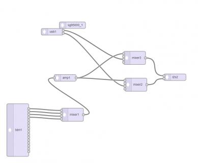

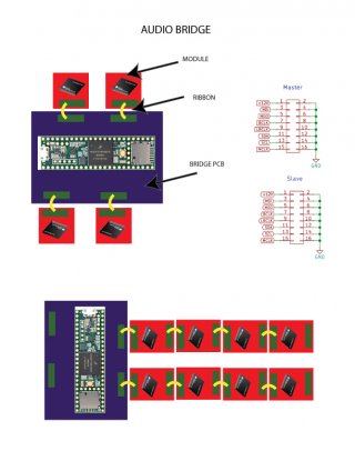

Hi Paul,
Thank you very much for your reply. I have been actively working on this project.
I was able to get this project moving with the sample parts, but now it's time for me to get it working with the target ADC and DAC modules. The plan is to work on those modules separately, with an "Audio bridge port" connector. The Teensy is the goal for now, but the plan is that by modularizing it we could theoretically use the modules on any MCU/DSP. This might open up the possibility to sell more of these individual modules to any maker for tinkering with high quality audio. In contrast, the bridge might make it easier for makers to hack together just the system they need, with simple modules like the ones that I've demonstrated above.
The Teensy Bridge schematic is attached to this reply. I based these connections off of the SGTL5000 schematics. By the way, I would recommend maybe adjusting the text on the audio shield description page to show the following information. It took some digging and comparing to come up with this simple chart.
I expose Shield 1 and Shield 2 pins two times so that you ultimately get 4 Bridge Connectors. The ADC/DAC modules that I'm designing have all ADC, and all DAC on the boards. Using this shield you'll be able to connect 2 of each as required by any given project. But this could be modified for a TDM mode strategy that could allow the shield to have a ton of inputs and outputs. I am making the decision now to design the boards for "single mode" or instead create modules with multiples of each DAC/ADC to utilize the full potential of the TDM with minimal "audio bridge ports" and cables. Obviously, having too many cables could make this cumbersome.
One possible configuration of my modules could include 16 inputs (two modules connected to Audio_Bridge_Port_Female_A1 and Audio_Bridge_Port_Female_B1) and 16 outputs (two modules connected to Audio_Bridge_Port_Female_A2 and Audio_Bridge_Port_Female_B2) if I designed my modules with maximum capacity (8 inputs and outputs on each)... Ultimately I want to design one module for each purpose (inputs/outputs) but have the ability to expand by adding input or output modules as required for any given project. But I'm also trying to avoid having too many channels on each module resulting in too much for the smaller requirements in smaller projects.
My modules will have > 110 SNR inputs and outputs. I'm going for highly-respectable sound quality - but not uber expensive audiophile grade.
How many DMIPS is the Teensy 3.6? How does it compare to an STM-32F767ZI for example? While the Teensy has proven itself to work just fine in my initial experiment, I'm nervous about having too many inputs and outputs and how it will fair. Any advice is greatly appreciated as I think about this project all the time! :)
  • TEENSY_AUDIO_BRIDGE_C1.pdf

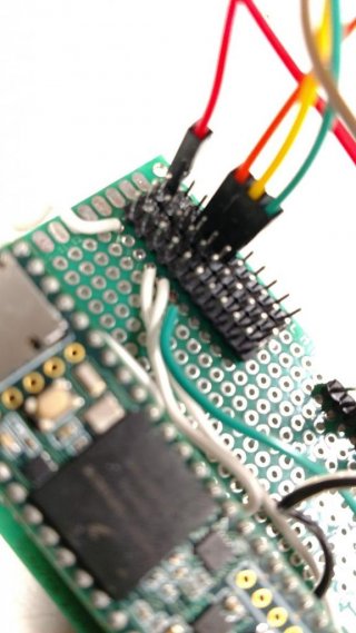

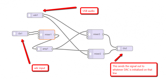

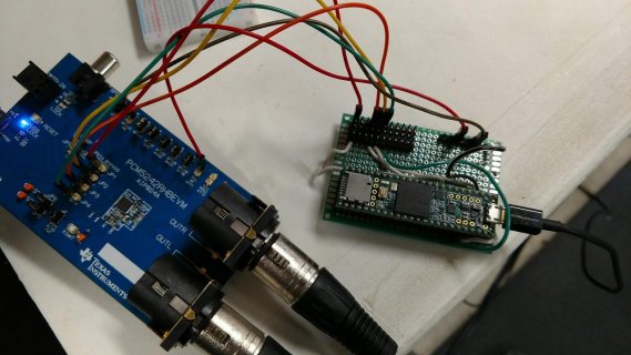

Hello,
Although this doesn't pertain to the PCM5102a, I didn't want to create a new thread because this project is related (let me know if I should). I purchased a PCM5242EVM and I've successfully connected it up to a Teensy. I chose the PCM5242 after much research on an easy to use, high quality device. It boasts 114db SNR and can drive both balanced (pro audio) and single ended (consumer audio) lines. It's perfect for a reasonably spec'd audio mixer. (costs $3.50 | 1ku).
For testing purposes I created a prototype "Audio Bridge" which is exposing 4 rows of "I2S/I2C" lines. The design is based on the "FreeDSP Expansion Connector" and it just makes it easier to connect everything up without thinking too hard and counting pins. It would also allow me to connect up 2 (or up to 4) of these PCM5242 to the same I2S/I2C line once I have it configured in TDM mode...
Right now I have the TI Purepath Console connected from the PC->USB->PCM5242EVM. This is controlling the I2C signals only and initializing the DAC. Then I have PC->USB->Teensy which is then sending the I2S signal to the PCM5242. So the Purepath initializes the DAC and the Teensy sends the I2S data. It's working, and sounds GREAT. Using the PurePath Console I can see all the different registers and settings, and there is a way to export the XML.
So now I have to figure out how to disconnect the Purepath I2C control (SDA/SCL) and connect it to the Teensy so that it can initialize the DAC (rather than the way it is now with the Purepath Console doing it). I could use some help with the drivers. Question: How do I go about converting this XML to the required I2C firmware driver? I'll be looking into this so any advice will be greatly appreciated. I'll share the PCM5242 firmware back to the teensy project once it works.
I'll probably start by looking at the code for the Teensy Hearing Aid (TLV320AIC3206). At least it's a comparable TI chip... Here goes! :)
