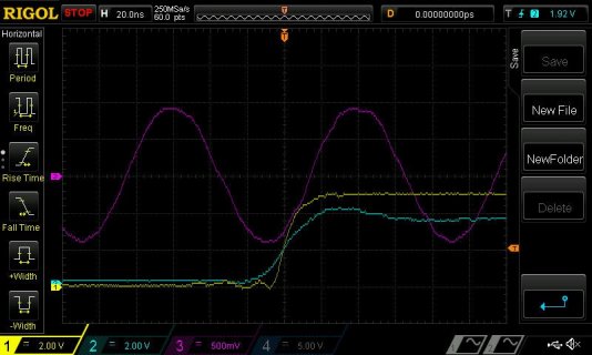

Here is a scope picture to show events... Trace 1 (Yellow) is the edge of a 100 KHz sq wave derived from the 10 MHz OCXO via the 74HC390 dual decade divider (Pin 23 CH1 positive going edge). Trace 2 (Light Blue) is the edge of the RFS 1PPS and also the synch trace (Pin 22 CH0 positive going edge). Trace 3 (Purple) is the 10 MHz OCXO sine wave = locked to Trace 1 sq wave.
I could adjust Trace 1 to lead or lag Trace 2 (very slow, sliding left or right using a manual control of the DAC value). As I did so, the count values for CH0 and CH1 came into close agreement until eventually they were co-incident. The shrinking count difference also agreed precisely with scope display, being one count value difference for every 20 nanoSecs (roughly) of scope Trace 1 versus Trace 2 separation (which agrees with the 48 MHz clock rate).
Typical values (every second) were:
Secs = 1200, CH0 Count = 19714, CH1 Count = 19714
Secs = 1201, CH0 Count = 5771, CH1 Count = 5771
Secs = 1202, CH0 Count = 39998, CH1 Count = 39998
The system clock is not precisely 48 MHz, so I think this is the reason why the readings are drifting in (absolute) value, but the co-incidence was a great pleasure to observe. And as the two traces drifted 20 nanoSecs apart again (Trace 1 moving to the right of Trace 2) then the values again differed by one count.
So I now have a very accurate method of reading the relative phases (difference) of the OCXO sq wave relative to the 1 PPS. Possibly by using some "maths" filtering on the numbers over periods of minutes, then I should be able to get a good control signal to automatically adjust the DAC. We shall see exactly how good. That's the next phase of work.
For anyone reading who is a newbie to "channels", here is my code snippets to enable them (do NOT use "pinMode" to set as inputs):

More experimental research to report... I have been playing with manual control of the DAC today and observing the count difference between CH1 and CH0. It looks to be very, very good. Could give me a "software phase detector" that is reliably accurate to a few nanoSecs. There is a degree of probability intoduced when you get down to a phase difference of one or two - or even zero - counts. This "flickers" say on "0" to "-1" and will depend on the probability of a system clock edge falling in the gap time between the channel readings. This seems also to be true of other values (e.g. difference = "2" etc). I therefore presume (and will verify experimentally) that this probability can give me "sub-integer" control of the phase comparison. If proved true, then by using some maths on the channel difference count values (percent time at "-1" and percent at "0") then it should prove a much superior method of "software phase control" in my PLL (of the RFS 1PPS and the 10 MHz OCXO) to that previously looking at D6/D5 pin values.
Another major advantage of this "software phase detector" is that it gives proportional values, not just "bang/bang" like the D6/D5 method. This means that professional PID (Proportional/Integral/Differential) control loop technology may be employed to rapidly get to the required phase lock in the minimum time. Is this a first? Have we just invented a new software phase control method :) !! Its cetainly independant of temp and the system clock crystal frequency.
