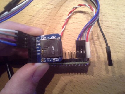

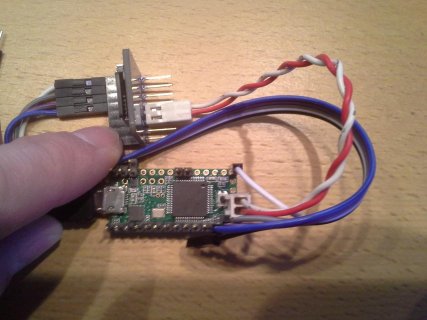

I want to use a microSD card on a Teensy3.1 so bought a microSD breakout board from Ciseco, because it is simple, small and cheap. A datasheet can be found here. I connected the boards using the supplied 10cm wires for digital pins and some other wires of about the same length for power/gnd like this:
teensy:
I used the example SDInfo from sdfatlib 20131225 and cardinfo from Arduino SD lib to test and both fail in the very first initialization step with error 0x1 (data 0xff). According to docs/output this means that no card seems to respond/be found. I used a NoName 2GB card and a Samsung 32GB SDHC card. Both produce the same output.
teensy:
| Teensy pin no. | Teensy pin name | I/O POD pin name |
| - | GND (near button) | GND |
| - | 3.3V (near button) | 3V3 |
| 10 | CS | SS |
| 11 | DOUT | MOSI |
| 12 | DIN | MISO |
| 13 | SCK | SCK |
