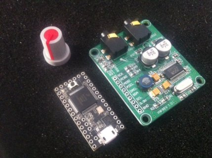

Hey All,
Just to say hi and to share my excitement with the potential Teensy3 has to offer to audio geeks.
I've been programming some fun dsp stuff in openframeworks (mainly for iphone) and can't wait to port it to teensy.
I ordered this DAC from Mouser part#932-MIKROE-506 on Paul's recommendation.
Curious if anyone has tried I2C yet as I'm hoping to give it a try this weekend.

Hi, Sorry to bump the thread again. I tried all weekend getting the DAC to work but I'm afraid I don't really know what I'm doing. I have the SDA and SCL (pins 18 and 19) hooked up to the SDA and DCL pins of the DAC board and GND and 3.3v.
Then I've been trying the WIRE/master_writer sketch to send data to it, but not getting any sound.
I'm assuming that I need to set up a timed interrupt for things to sound right but was counting on hearing some kind of noise just by sending random data in the main loop.
Here's the datasheet for the DAC board:
http://www.mouser.com/ds/1/272/acodec_manual_v100-11666.pdf
Perhaps someone could give me a hint to how to get it working. Should I connect anything in addition to the I2C?
I would be ever so greatful
Thanks for any tips!
Alex

One possibility: I2C is a shared bus which requires pullup resistors, for example 4.7 k to Vcc because the outputs are open-collector type (both SCL and SDA lines stay at 0 V without the pullups). You can have the pullup resistors on the CPU side, or the device side, or in between but they have to be there.
EDIT: nevermind, the schematic you linked to shows the DAC board does provide 1k pullups on SDA and SCL. Have you checked that the 3.3V supply is what you think it is? I don't know how much current the DAC board needs, maybe the voltage is getting loaded down?
EDIT 2: Looks like that board actually uses the 3-wire SPI interface (MISO, MOSI, SCK) to transfer audio data. The 2-wire I2C interface is only for a control channel (setting up internal registers). You need an actual datasheet to use the part, the brochure you linked to does not provide the programming and setup info.

A quick mention of I2S is probably worthwhile. Even though that board has SPI-like signal names, the I2C peripheral on the chip is the one to used for sending and receiving the audio data. SPI is similar and might be usable for audio, but I2S is designed for specifically for audio. Like most codecs, both I2C is also used. Even though these 2 protocols have similar names, differing only by "C" vs "S", they are in fact completely different.
I2C is for configuration and infrequent control messages. I2S is for continuously streaming audio.
