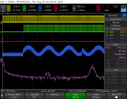

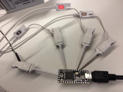

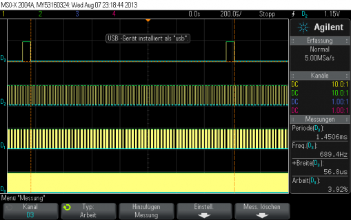

This was my measurement setup:
I can post a screenshot of the oscilloscope screen tomorrow, don't have that in my cloud :mad:
Thanks hpyle and everyone who contributed for this awesome lib!
With best regards
Ben

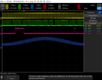

Edit: The Screenshots I promised:
The Measurements in the lower right corner are:
Ansteigen == Rise Time
Abfall == Fall Time
Über == Overshoot (more than 20%, is this normal?)
Freq == Frequency, this is 2 channels, 16 bits each, 44.1kHz sampling rate --> 2*16*441000 = 1.4112 MHz
I hope this is useful to anyone. By the way, I have access to very good measuerment equipment. Scopes, Freq. counters, spectrum analyzers, signal generators... If this is of any use for the development of this library, let me know and I will provide you with the measurement you need.

@ben Very nice.
In your first scope screenshot: notice that the data word is delayed one bit "behind" the frame. I2S data frames start one bit later than the frame-clock, and so they also finish one bit later.
In the second screenshot, are you looking at overshoot on the bit-clock line? I wish my scope was fast enough to even see that ;)

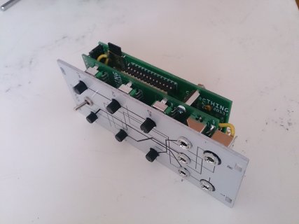

It's an usb audio interface; it will have one wm8740 dac and one wm8786 adc, two pga4311 digital volume control, two fully differential opamps to convert from unbalanced to balanced inputs (wm8786 has balanced inputs), and an input impedance selector, to switch between line input and instrument input (for bass/guitar). BTW I don't think you can swap chips that easily, as the wm8731 is a codec while these chips are dac/adc only, and they need some glue circuitry to work as stated in the datasheets. I hope that the circuit I'm working on will serve as a good starting point for a nice audio interface based on the teensy. I repeat, I will post schematics asap.
I did another measurement to find out the CPU load while I2S Tx is running. To do so, I held a pin high during the ISR that feeds new data to the I2S transmit buffer. I use Pin 0 for this.
It turns out the pin is high for about 4% of the time and I think this is roughly equal to the CPU load the ISR imposes. The ISR itself is relatively small, it generates a triangular pattern on one channel, changing one LSB every sample. The other channel is constantly at the lowest value.
Here is another screenshot from my scope:
D0 D1 and D2 are the I2S bus. D3 is the pin I used to indicate the ISR is running (Teensy 3 Pin 0).
The measurements in the lower right corner mean:
Periode = period
Freq. = frequency (which is 1/period of course)
+Breite = signal high time (how long the ISR is active)
Arbeit = Duty cycle (what percentage of the whole time the ISR is active)
ah, i figured effects pedal or something. curious to see what you come up with in terms of usb audio.
and sure, i'd have to redo my board somewhat, but since i'm not using the adcs on the wm8731 i might as well ... it's running off -12/12v so the "glue circuitry" won't be a big deal.

Over the last several days, while waiting for beta testers on the low power improvement and mac bug fix, I've started working on an audio API for Teensy.
I've been fiddling with DMA for dual-PWM output (a pair of 1:256 scaled resistors for high res). Much of this work will also carry over the I2S, but for the moment I'm concentrating on PWM while I refine the API. I hope to get to I2S in a couple weeks.
Here's a scope screenshot of the DMA-based PWM output...
The top 2 traces are PWM on pins 3 and 4. The red trace is a pulse from the interrupt that feeds more data into the DMA's buffer.
The blue trace is a simple R-C filtered output, using a 1K resistor on pin 3 and 240K resistor on pin 4, both driving a 10 nF capacitor. Only 4 interrupts occurred, so the buffer didn't get refreshed with new data on the far right side of the trace, where it begins replaying the stored buffer.
The math trace is a FFT. There a fair amount of DC from the initial part of the waveform, so the 1 kHz energy is pretty close to DC on this scale. In the middle, you can see energy at 43 and 45 kHz, and of course a lot of stuff around 88.2 kHz for the PWM carrier.
While this screenshot is just PWM waveforms, most of what I'm actually working on is the API and software infrastructure to make audio projects really easy. The API allows objects to be connected together, so audio data flows automatically. The idea is to free up the Arduino sketch from moving data around, so you can use Arduino style programming to control audio parameters and whatever other hardware you've connected.

This is great news. I understand the API will configure the DMA-Parts of the Kinetis to allow streams of audio data to flow into and out of the buffers to various peripheral devices such as the PWM-Generator, the I2S subsystem, or the DAC. Right? Do you plan to make the source of a stream selectable from an ADC, I2S input or an internal function generating the data?
The math trace is a FFT. There a fair amount of DC from the initial part of the waveform, [...]
The part of the waveform where the sine is played actually has a higher DC component than the "silence" in the first millisecond.
Maybe this question comes a bit early, but is the Sample rate equal to the PWM freq.? It'd be great if the PWM frequency could be made a multiple of the sample rate, thus reducing the required steepness (order) of the low pass filter.
I know this message is something of a tease.[...]
The sample rate is 44.1 kHz (actually 48 MHz divided by 1088, which works out to be 44.117647 kHz). The PWM carrier is double the sample rate: 88.2 kHz.
I might try increasing to 176.4 kHz carrier at some point, but that's pushing the limits to very difficult timing. The DMA event occurs at the compare match, not the beginning of the cycle. It's unfortunate Freescale didn't provide a way to create trigger the DMA at the beginning of the PWM cycle (at least not any way I could find). Triggering within those last 16 clocks is dangerously close to the latency imposed by the DMA engine to load the transfer descriptor. If there's any bus arbitration, like another DMA channel, or the USB's DMA controller, or interrupt stack framing, or even a load or store multiple instruction, the DMA might get delayed until the first part of the next PWM cycle. Maybe that's not a huge problem if it's unlikely to occur, since it'll just cause one PWM pulse to be repeated instead of the correct output during that cycle.
Here's a couple more scope screenshots.
I've finally got the automatic updating working, so the sine wave keeps updating continuously now. :)
The FFT in this screenshot shows only the 20 kHz audio band. I believe that harmonic distortion at 2 kHz is mostly from my poorly matched resistors. At least I hope it is.
The red trace is the CPU usage.
Here you can see a zoom in to the CPU usage. The short pulses are the DMA interrupt. The long pulse is the updating interrupt, which runs at a low priority so the DMA and other interrupts can still work. During this update time, the sine wave data is being created. As more audio processing objects are created, this is where their CPU usage will go.
