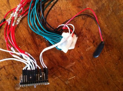

@Senescence. This is a bit embarrassing, but here you go, an image of my "Heath Robinson contraption" setup for the teensy3.0 and octows2811. This is running a small array of 8x34 pixels. All the led strips use a common ground and this is also common with the Teensy. They are joined by the battery terminal. All the led strips positives are common to one wire which also feeds the teensy and this is joined to gether by the battery. As these strips are short and don't require much juice, i did not bother feeding additional supply or connecting at the far ends to ground either.The resistors are 100Ohm. This is not the best solution, but it works for me. All runs from 4xAAA batteries for a reasonable time. Sorry about this disgraceful display of spaghetti, neatness has never been one of my things.

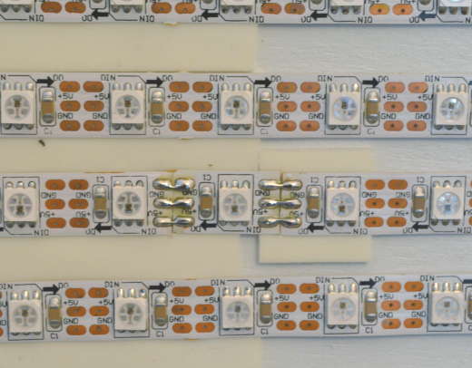

here is an image of the soldering i had to do to remove the bad sections of the 144led/m strips for a different project. These are now encased in a clear poly tube.

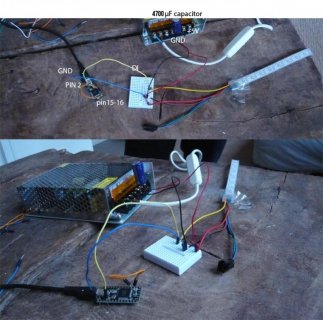

Here's a picture of what i tried to do ...
Can you help me finding what i did wrong ?
As said by someone before this post, shorting 5V with DIN would be the explanation ... but i don't see where that happens in my wiring !
I'm not using the +5v of the Teensy ... only the 5V of my power supply ... which seems very stable btw ... after testing !
And as indicated in the octo tutorial, i'm connecting the GND of the teensy with the GND of the led strips and GND of the power supply ...
DIN is connected to PIN 2 here as i'm testing with only one strip ...
Pins 15 and 16 are connected together ...
So ... when i do this, in turn on the power supply and the strip flashes and first led burns ...

Your power supply doesn't appear to be grounded. Also, it's difficult to see the PSU labels from the pictures, but if you're connecting anything from the teensy or strip to the AC ground on the PSU, that's certainly not the intended GND! There should be a V+ and a V- on the PSU - the "V-" is the GND you want for your 5V circuits.
My power supply is not grounded cause i have no ground at home in the plugs :(
There is nothing connected from the PSU ground ... The GNDs of teensy and strip are connected to COM/-5V of the PSU ...

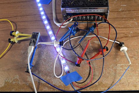

I just tried a similar setup here. Seems to work fine.
One thing to try is decreasing the power supply voltage. Yours looks like the same model. That little "+V ADJ" pot can adjust the voltage. Lowering it to about 4.6 or 4.7 might help the WS2811's to receive Teensy3's 3.3V signal.
Of course, the best way to drive these LEDs is through a 74HCT245 buffer that increases the signal to 5V.
