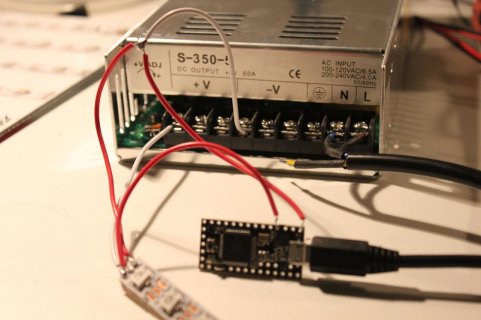

Teensy3 + RGB strips wiring
i.
V- psu -> teensy gnd -> led gnd
V+ psu -> led +5V
teensy pin16 -> 220 ohm -> led DIN
usb power -> teensy microUSB

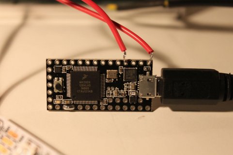

Did you connect pin 15 and 16 together ? The picture doesn't show any of the connections.
ii.
V+ psu -> teensy Vin -> led +5V

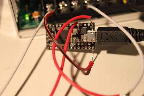

(this section should require cutting something something, but check on the pictures if I have done that, because I simply never really understood what to cut)
It's not easy to see it without a magnifying glass but there is actually two pads under the teensy (VUSB and VIN) that are soldered together with a very very thin connection. It's this little connection that you have to cut/remove.
That is why I included some images of the back of my Teensy, because I was not sure if I had done it or not, or where to cut, and what to cut if I had not :rolleyes:
Better yet, how do I test if I have done it correctly anyway?
Would the Leds fail to light up when I am only using USB power then?
Oh yeah, I didn't use OctoWS2811 lib for this test, because I only wanted to figure out how to purely use external power.
Once that part is taken care of, I am sure I'll go over to OctoWS2811 at one point :cool:
Hi guys,
I tried to build a 28x16 pixel array following the octoWS2811 tutorial but something went wrong. So I came back to a smaller setup with a single strip led, as documented by Paul Stoffregen, but my setup doesn't work. I built one circuit with Teensy 3.0 powered by USB cable and other one with +5V connected to VIN pin (VUSB and VIN cut apart). I loaded on the Teensy the Basic Test example but it doesn't work.
Please look at the attached pics. Any suggestion for a dummy? :eek:
Alecmd, I don't know much about this, but when I had a few problems I started from the beginning again. Might be worth going through the build step by step. Load the Blink sketch and see if this works by getting the built in Led to flash. If this works after you unplug your usb cable, you know you are powering the Teensy from you non-USB supply. Check the voltage with your meter to see what you are getting. Load basic test for the octows2811 and hook up just a few leds to pin 2. ensure that you share a common ground for the Leds and the Teensy. The wiring in the pic looks right, so it might be worth checking your sketch, or upload the original basic test sketch without alterations (it still worked for me even with the incorrect number of leds declared. I found that I got flickering if I did not use a resistor (100 Ohm) and needed to have the CPU speed at 48MHz. It sounds a bit patronising, i know, but I found that I had to go back and check the most basic aspects.
Looks like it ought to work, from those photos.

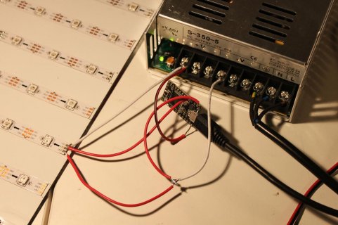

I did get it to work using this wiring:
teensy pin16 -> 150 ohm -> led DIN
Basically I ended up with trying a smaller resistor from the teensy to the led DIN.
I went from no light at 220 ohm,
to much flicker with 180 ohm,
to smooth and correct light with 150 ohm.
Could I have calculated this beforehand somehow?
My psu gives 5.10-5.13v dc.
In any case, I got it to run and was happy with that. I let it rest for a while, and when I came back to try it again I plugged in the psu and the light ran smooth like no tomorrow.
Suddenly I see a small puff of smoke, and the light stop.
After looking at the teensy this is what presents itself:
http://ultraimg.com/images/DAafF.jpg
What happened :confused:
Could I have prevented it?
What can I do to make sure it doesn't happen when I try it with the other teensy I have laying around?
(I do have some 1N5817RL diodes, some 74hct244, and some 74lvc245 somewhere. Could I perhaps use any of those to prevent this? If so, how would the wiring be?)
Not easily. The ideal resistor depends on the type of wires you use and their spacing to each other. If you use coax or cat5 or cat6 cable, the impedance is specified because those cables are made with specific plastics and the spacing the wires is carefully controlled. Most coax cables are 50 of 75 ohms. Twisted pairs in ethernet cables are 100 ohms.
With just ordinary wires that don't have specially made plastic insulation and whose position relative to the GND wire, there's no much you can do. In theory, it could be calculated somehow, but in practice just trying resistors in the 50 to 300 ohm range is much easier.
The +5V line touched the AGND pin.
The part that burned is the inductor between +5V and AGND, so this is certainly what happened.
Less exposed metal on the +5v wire and/or better position of the wire.
The burned part is an inductor. If you have a magnifier, bright light, and fine tip on a soldering iron, you be able to solder a wire in its place and maybe get the board to work again. It's ok to replace with a wire. The inductor just helps isolate the analog stuff from high frequency noise that might (or might not) be present on the digital wires. Using only a wire will allow the potential source of noise to get into the ADC, but that's a relatively minor issue.
Whether the board can work again depends on what voltage the chip was exposed to as the part burned. If 5V got into the AGND pin on the chip, then the chip probably got destroyed. But if the part burned fast, the chip work again when the part is replaced by a wire.
