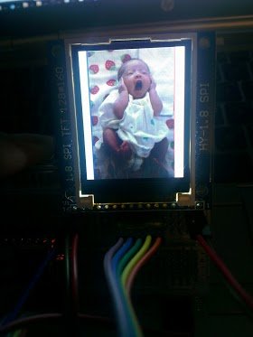

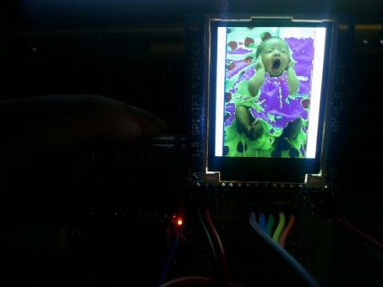

Hi Peter,
Thanks for your port to Teensy3, it was useful for me to try out these modules (and oi! fellow Aussie!).
Just want to know that in your Teensy3_ST7735.h, the RGB macro has an error.
#define RGB(r,g,b) ((b&0xf8)<<8|(g&0xfc)<<4|(r&0xf8)>>3)
I think should be
#define RGB(r,g,b) ((b&0xf8)<<8|(g&0xfc)<<3|(r&0xf8)>>3)
[5,6,5]
The function Color565 in Teensy3_ST7735.cpp has the correct shifts, but still in RGB instead of BGR.

Code that doesn't work when trying to load the bmp
  This is an example sketch for the Adafruit 1.8" SPI display.
  This library works with the Adafruit 1.8" TFT Breakout w/SD card
  ----> http://www.adafruit.com/products/358
  as well as Adafruit raw 1.8" TFT display
  ----> http://www.adafruit.com/products/618
  interface (RST is optional)
  products from Adafruit!
#include <Teensy3_ST7735.h>
// TFT display and SD card will share the hardware SPI interface.
// Hardware SPI pins are specific to the Arduino board type and
// cannot be remapped to alternate pins.  For Arduino Uno,
// Duemilanove, etc., pin 11 = MOSI, pin 12 = MISO, pin 13 = SCK.
#define SD_CS    4  // Chip select line for SD card
#define TFT_CS  10  // Chip select line for TFT display
#define TFT_DC   9  // Data/command line for TFT
#define TFT_RST  8  // Reset line for TFT (or connect to +5V)
//Adafruit_ST7735 tft = Adafruit_ST7735(14, 20, 7);
Teensy3_ST7735 tft(14, 20, 7);
void setup(void) {
  // Our supplier changed the 1.8" display slightly after Jan 10, 2012
  // so that the alignment of the TFT had to be shifted by a few pixels
  // this just means the init code is slightly different. Check the
  // color of the tab to see which init code to try. If the display is
  // cut off or has extra 'random' pixels on the top & left, try the
  // other option!
  // If you are seeing red and green color inversion, use Black Tab
  // If your TFT's plastic wrap has a Black Tab, use the following:
  tft.initR(INITR_REDTAB);   // initialize a ST7735S chip, black tab
  // If your TFT's plastic wrap has a Red Tab, use the following:
  //tft.initR(INITR_REDTAB);   // initialize a ST7735R chip, red tab
  // If your TFT's plastic wrap has a Green Tab, use the following:
  //tft.initR(INITR_GREENTAB); // initialize a ST7735R chip, green tab
  delay(10000);
  if (!SD.begin(19)) {
    Serial.println("failed!");
    return;
  Serial.println("OK!");
  bmpDraw("parrot.bmp", 0, 0);
// This function opens a Windows Bitmap (BMP) file and
// displays it at the given coordinates.  It's sped up
// by reading many pixels worth of data at a time
// (rather than pixel by pixel).  Increasing the buffer
// size takes more of the Arduino's precious RAM but
// makes loading a little faster.  20 pixels seems a
// good balance.
#define BUFFPIXEL 20
void bmpDraw(char *filename, uint8_t x, uint8_t y) {
  File     bmpFile;
  int      bmpWidth, bmpHeight;   // W+H in pixels
  uint8_t  bmpDepth;              // Bit depth (currently must be 24)
  uint32_t bmpImageoffset;        // Start of image data in file
  uint32_t rowSize;               // Not always = bmpWidth; may have padding
  uint8_t  sdbuffer[3*BUFFPIXEL]; // pixel buffer (R+G+B per pixel)
  uint8_t  buffidx = sizeof(sdbuffer); // Current position in sdbuffer
  boolean  goodBmp = false;       // Set to true on valid header parse
  boolean  flip    = true;        // BMP is stored bottom-to-top
  int      w, h, row, col;
  uint8_t  r, g, b;
  uint32_t pos = 0, startTime = millis();
  if((x >= tft.width()) || (y >= tft.height())) return;
  Serial.print("Loading image '");
  Serial.print(filename);
  Serial.println('\'');
  // Open requested file on SD card
  if ((bmpFile = SD.open(filename)) == NULL) {
    Serial.print("File not found");
    return;
  // Parse BMP header
  if(read16(bmpFile) == 0x4D42) { // BMP signature
    Serial.print("File size: "); Serial.println(read32(bmpFile));
    (void)read32(bmpFile); // Read & ignore creator bytes
    bmpImageoffset = read32(bmpFile); // Start of image data
    Serial.print("Image Offset: "); Serial.println(bmpImageoffset, DEC);
    // Read DIB header
    Serial.print("Header size: "); Serial.println(read32(bmpFile));
    bmpWidth  = read32(bmpFile);
    bmpHeight = read32(bmpFile);
    if(read16(bmpFile) == 1) { // # planes -- must be '1'
      bmpDepth = read16(bmpFile); // bits per pixel
      Serial.print("Bit Depth: "); Serial.println(bmpDepth);
      if((bmpDepth == 24) && (read32(bmpFile) == 0)) { // 0 = uncompressed
        goodBmp = true; // Supported BMP format -- proceed!
        Serial.print("Image size: ");
        Serial.print(bmpWidth);
        Serial.print('x');
        Serial.println(bmpHeight);
        // BMP rows are padded (if needed) to 4-byte boundary
        rowSize = (bmpWidth * 3 + 3) & ~3;
        // If bmpHeight is negative, image is in top-down order.
        // This is not canon but has been observed in the wild.
        if(bmpHeight < 0) {
          bmpHeight = -bmpHeight;
          flip      = false;
        // Crop area to be loaded
        w = bmpWidth;
        h = bmpHeight;
        if((x+w-1) >= tft.width())  w = tft.width()  - x;
        if((y+h-1) >= tft.height()) h = tft.height() - y;
        // Set TFT address window to clipped image bounds
        tft.setAddrWindow(x, y, x+w-1, y+h-1);
        for (row=0; row<h; row++) { // For each scanline...
          // Seek to start of scan line.  It might seem labor-
          // intensive to be doing this on every line, but this
          // method covers a lot of gritty details like cropping
          // and scanline padding.  Also, the seek only takes
          // place if the file position actually needs to change
          // (avoids a lot of cluster math in SD library).
          if(flip) // Bitmap is stored bottom-to-top order (normal BMP)
            pos = bmpImageoffset + (bmpHeight - 1 - row) * rowSize;
          else     // Bitmap is stored top-to-bottom
            pos = bmpImageoffset + row * rowSize;
          if(bmpFile.position() != pos) { // Need seek?
            bmpFile.seek(pos);
            buffidx = sizeof(sdbuffer); // Force buffer reload
          for (col=0; col<w; col++) { // For each pixel...
            // Time to read more pixel data?
            if (buffidx >= sizeof(sdbuffer)) { // Indeed
              bmpFile.read(sdbuffer, sizeof(sdbuffer));
              buffidx = 0; // Set index to beginning
            // Convert pixel from BMP to TFT format, push to display
            b = sdbuffer[buffidx++];
            g = sdbuffer[buffidx++];
            r = sdbuffer[buffidx++];
            tft.pushColor(tft.Color565(r,g,b));
          } // end pixel
        } // end scanline
        Serial.print("Loaded in ");
        Serial.print(millis() - startTime);
        Serial.println(" ms");
      } // end goodBmp
  bmpFile.close();
  if(!goodBmp) Serial.println("BMP format not recognized.");
// These read 16- and 32-bit types from the SD card file.
// BMP data is stored little-endian, Arduino is little-endian too.
// May need to reverse subscript order if porting elsewhere.
uint16_t read16(File f) {
  uint16_t result;
  ((uint8_t *)&result)[0] = f.read(); // LSB
  ((uint8_t *)&result)[1] = f.read(); // MSB
  return result;
uint32_t read32(File f) {
  uint32_t result;
  ((uint8_t *)&result)[2] = f.read();
  ((uint8_t *)&result)[3] = f.read(); // MSB
  return result;
I did some crazy code to test if the data that comes back from the SD card is actually right
So I printed out the RGB values and I wrote some code to write the RGB values to the screen to make sure things are supposed to work
Seems the image is busy forming http://www.flickr.com/photos/92380311@N04/8875762347/, colours are off, but at least not the buggy image as when it is read from the SD card and printed so there is probably something wrong with the example code I am using.
Does anybody have some code I can use to read an image from the SD card and display it?

I've also noticed that I cannot get any image from SD, doesn't give any error but screen remain black, I play just twice with sd cards so I'm not an expert, just opened the sketch and runned (before I copy in the sd card the file parrot.bmp).
I'm little confused about this library, actually the official Adafruit one claims to be Teensy 3/3.1 compatible and the Paul's version looks much different inside. I'm not sure wich one I should be use, actually I'm working with Paul one, wich one I should use?
I believe Adafruit's code only parses a particular BMP format which isn't the default most people use. I recall seeing info in their tutorial about how to convert to the required special format.
Thanks Paul, I'm actually use your connected in SPI, is this the faster mode? If I remember well I've read somewhere they use bmp little endian encoded, I will try later.
Mmmm, I've try 6 different SD cards with the parrot.bmp file proposed by adafruit that should be ok but I just got from garbage to blank screens. Tried also sdfat to check the sd connection and it's consistent with SD library and SDFat one, I just noticed some screen flickering with SD and SDfat tests probably caused because the tft it's not initialized, well, adding tft initialization on file benchSD.ino and bench.ino cause SD stop working. I will do some further experiments with the Adafruit ST7735 to see if there's some changes...
Thanks for proposal xxxajk but I'm trying to get library working first, then probably will like to be a nice weekend project doing some experiments!
Apart SD, display works really fast.
sd one. Just tryied now the adafruit ST7735 library, same file spitftbitmap.ino. This time I got only white or black screens! It's funny that sketch inform me though serial that parrot.bmp it's correctly loaded.
Looks like that SD library doesn't break the normal functionalities of the tft library, I merged inside a tft sketch the cardInfo.ino sketch from sd library and tft worked correctly the sd retuned this by serial:

Got some results, Using an SDHC 4giga card (fat32) at 48Mhz with Teensy3.0 and Adafruit TFT library I finally visualized parrot. Using same exact configuration with Paul library result in a Black screen.
Looks like the SD cards quality have an important role with SD library but with Paul library there's something breaks just the correct file retrieve or maybe SPI it's too fast for SD card.
