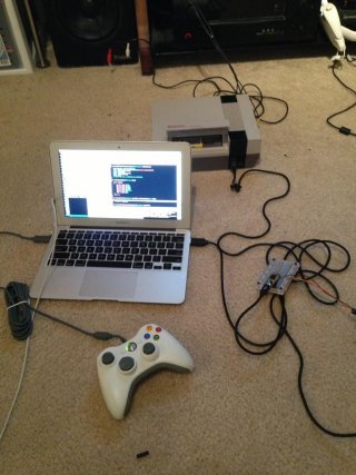

This one is relatively simple, but its my first micro-controller project and it left me feeling like this: http://www.youtube.com/watch?v=wGKxWatPkd0
Wrote two pieces of software, first is on the Teensy itself, all it needs to do is listen for the signal from the NES and then set the data line low or high appropriately for each button.
The other piece is on the computer to act as a translator for the HID device, it sends a packed byte each time the input changes over serial to the Teensy. Once the Teensy gets USB-Host support I hope to be able to cut out the need for the computer at all.
