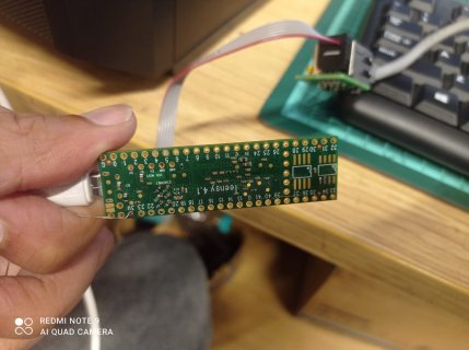

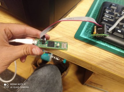

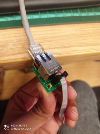

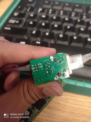

i have teensy 4.1 and pjrc ethernet kit .i connect it as per you guideline but when ethernet cable which come from router switch insert to the rj45 and teensy is also connect to the pc then led are not blink of rj45. i try to upload a code for static and dynamic both but it not ping or not show on web browser also. this is some pic of our connection . pls help i am so frustrated because i am try from last 3 day but not solve.

From that photo your Teensy is the "no ethernet" version, it doesn't have the ethernet chip next to where the cable connects.
but it is teensy 4.1 so i think its have a ethernet. our connection is ethernet cable come from router connect to rj45 and rj45 connect to teesy4.1 via 6 ribbon and teensy further connect to the pc through usb.
Compare the photos on Sparkfun's website. Teensy 4.1 with ethernet versus Teensy 4.1 without ethernet. Look at the location between the main processor and the 6 pins for the ethernet ribbon cable.
Your photo clearly shows the version of Teensy 4.1 without the ethernet chip.
The good news is this is a pretty easy fix. Just get another Teensy 4.1 with the ethernet chip and save this no-ethernet version for another project where you don't need ethernet.
